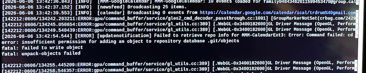

                  reilley @sdetweil
                  @sdetweil - I don’t use PM2, but I went ahead and replicated the steps you suggested to create that some file.txt log file and the appropriate searches. The only thing of note I saw was an error about MMM-CalendarExt3 not having permission to enter objects. Not sure if that would have any bearing on the MMM-GoogleCalendar module. Image attached.
                  By the way, I tried git pull to update MagicMirror, but being told I can’t fast-forward for some reason.
                    sdetweil @reilley
                    @reilley insufficient permissions on git
                    Sounds like you might have used
                    sudo git clone
                    Otherwise, this is a sign of sd card troubles coming soon
                    this permissions trouble could also explain the module update problems
