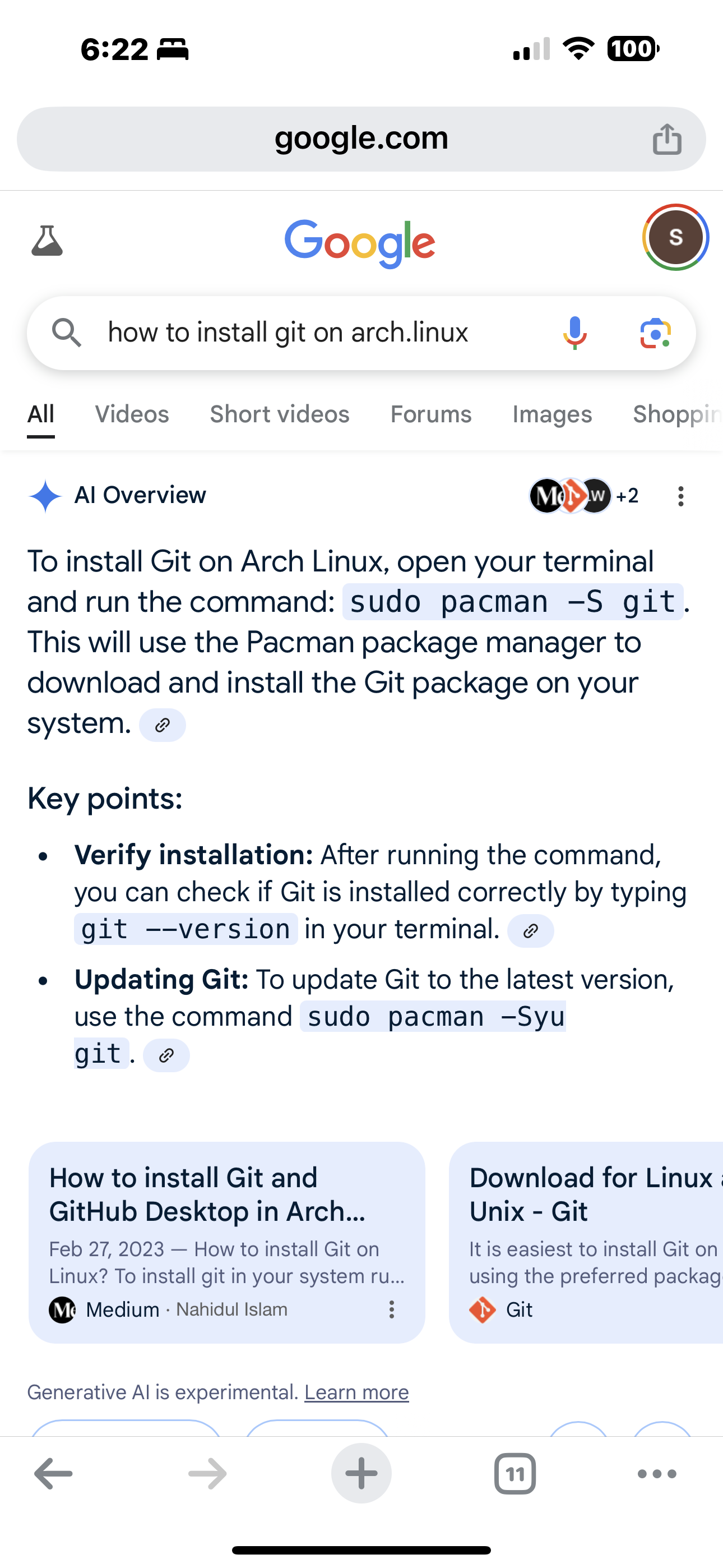

                          sk8josh @sdetweil
                          @sdetweil Help! Trying to use your script on a Orange Pi Zero 2W running Arch Linux (orange Pi version)
                          When i run the script I get:
                          install log being saved to /home/joshw/install.log
                          Updating packages …
                          sudo: apt-get: command not found
                          Update failed, retrying installation …
                          Installing helper tools …
                          Check current Node installation …
                          Node currently installed. Checking version number.
                          Minimum Node version: v20.18.1
                          Installed Node version: v22.14.0
                          No Node.js upgrade necessary.
                          Check current NPM installation …
                          NPM currently installed. Checking version number.
                          Minimum npm version: V10.8.2
                          Installed npm version: V10.9.2
                          No npm upgrade necessary.
                          Cloning MagicMirror …
                          bash: line 494: git: command not found
                          Unable to clone MagicMirror.
                          [joshw@Opi ~]$ ^C
                          [joshw@Opi ~]$
                          I cannot figure out how to 'install GIT" I have been at this for hours.
                          Thanks in advance
                          Josh.
                            sdetweil @sk8josh
                            @sk8josh
                            my script doesn’t work on arch linux as it depends on apt
                            also it would only install latest release 2.30.0
                            google is your friend
