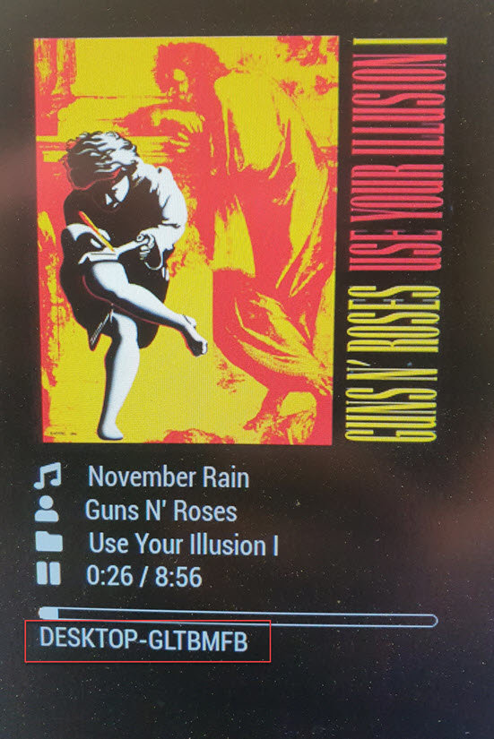

            ELMAGO
            Hello
            I would like that if the name of the device is for example, DESKTOP-GLTBMFB as on the image, the module does not appear.
            alt text
            S ? 2 Replies Last reply Reply Quote 0
              sdetweil @ELMAGO
              @ELMAGO Ok… let me feed that back…
              you have multiple devices capable of playing spotify music, and you would like to prevent/limit the active playing display to just certain devices (your phone, but not your teenagers for example).
