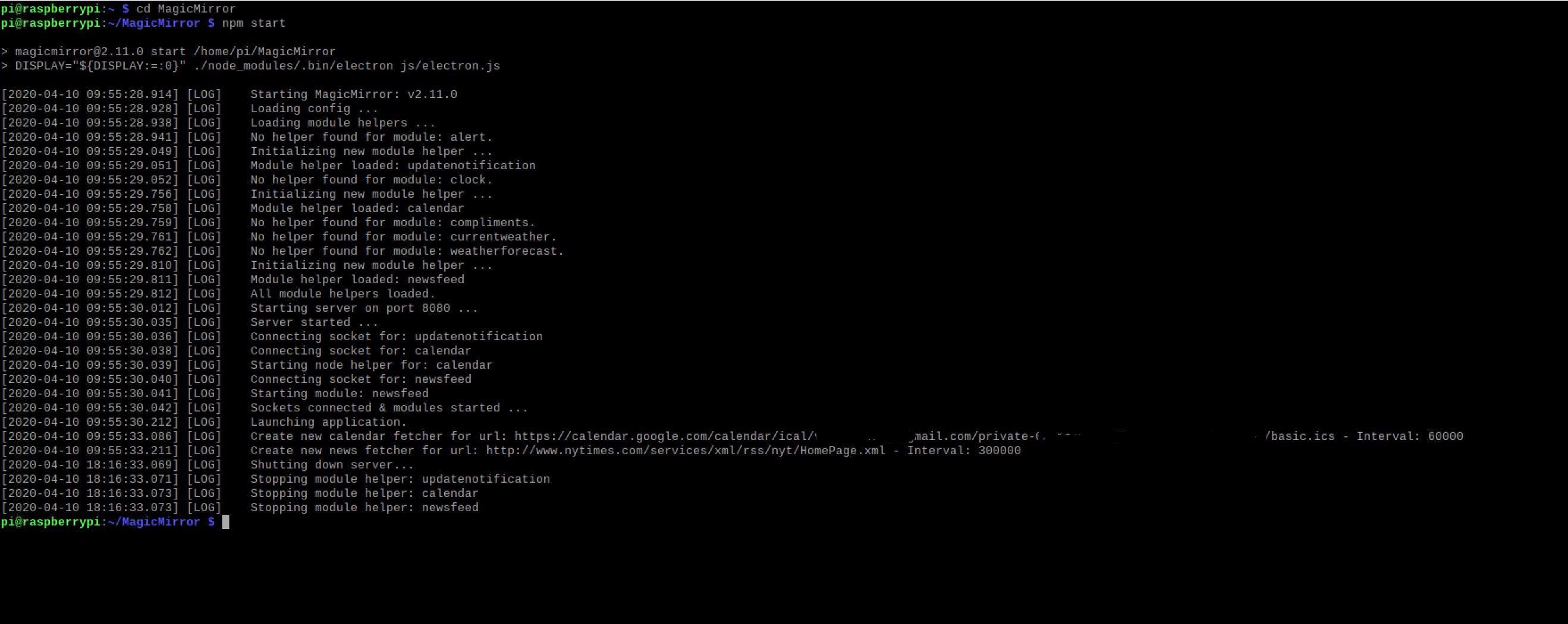

                        vanced54 @sdetweil
                        @sdetweil where do I do the node debug.js?
                        I tried it but doesn’t seem to worka22cc263-c285-48e6-bf1c-420fccb1e735-image.png
                        I did edit the debug.js file with the same link.
                          sdetweil @vanced54
                          @vanced54 you have to be in the MagicMirror/modules/default/calendar folder
                          V 1 Reply Last reply Reply Quote 0
