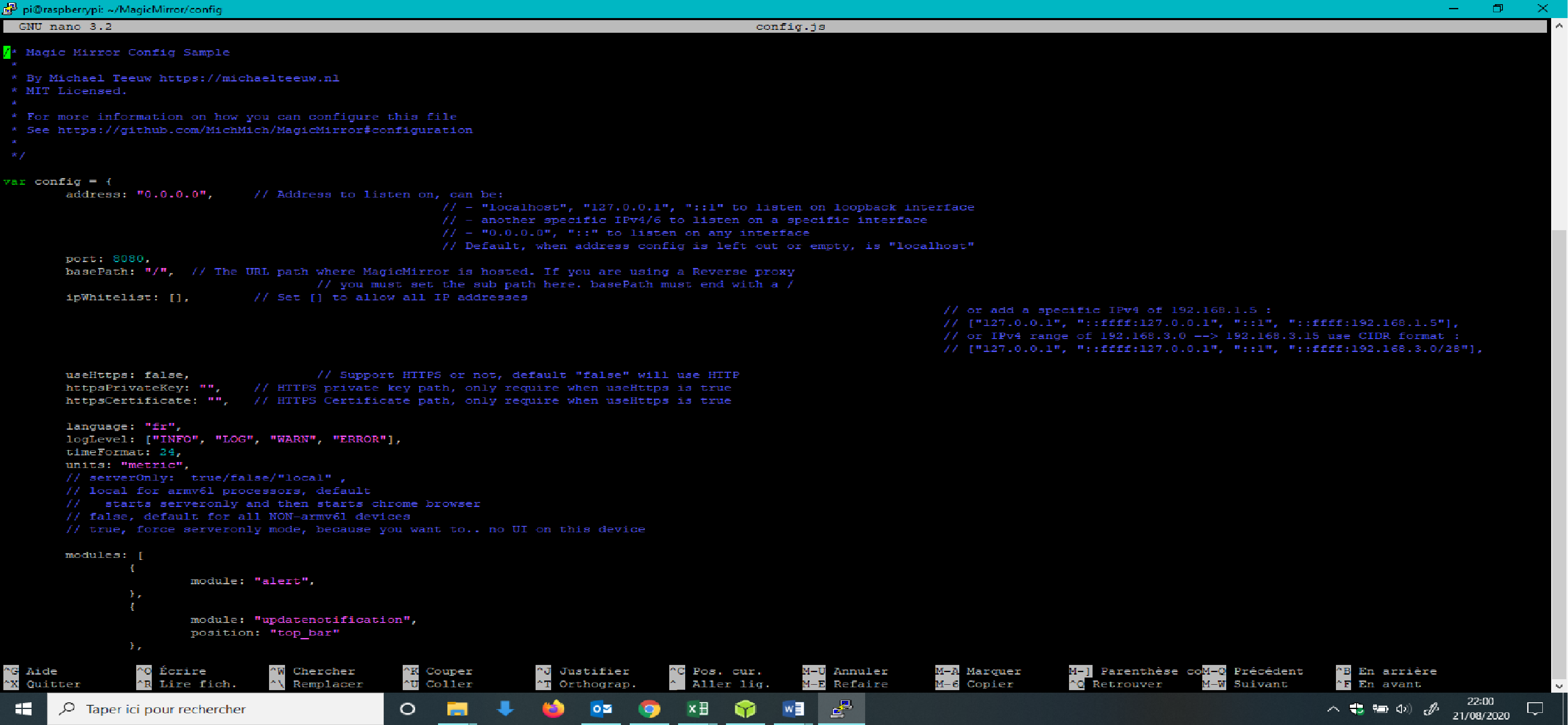

        RIKKO14
        I do this :
        and type pm2 restart 0, but my screen of MM is steel powered off…
