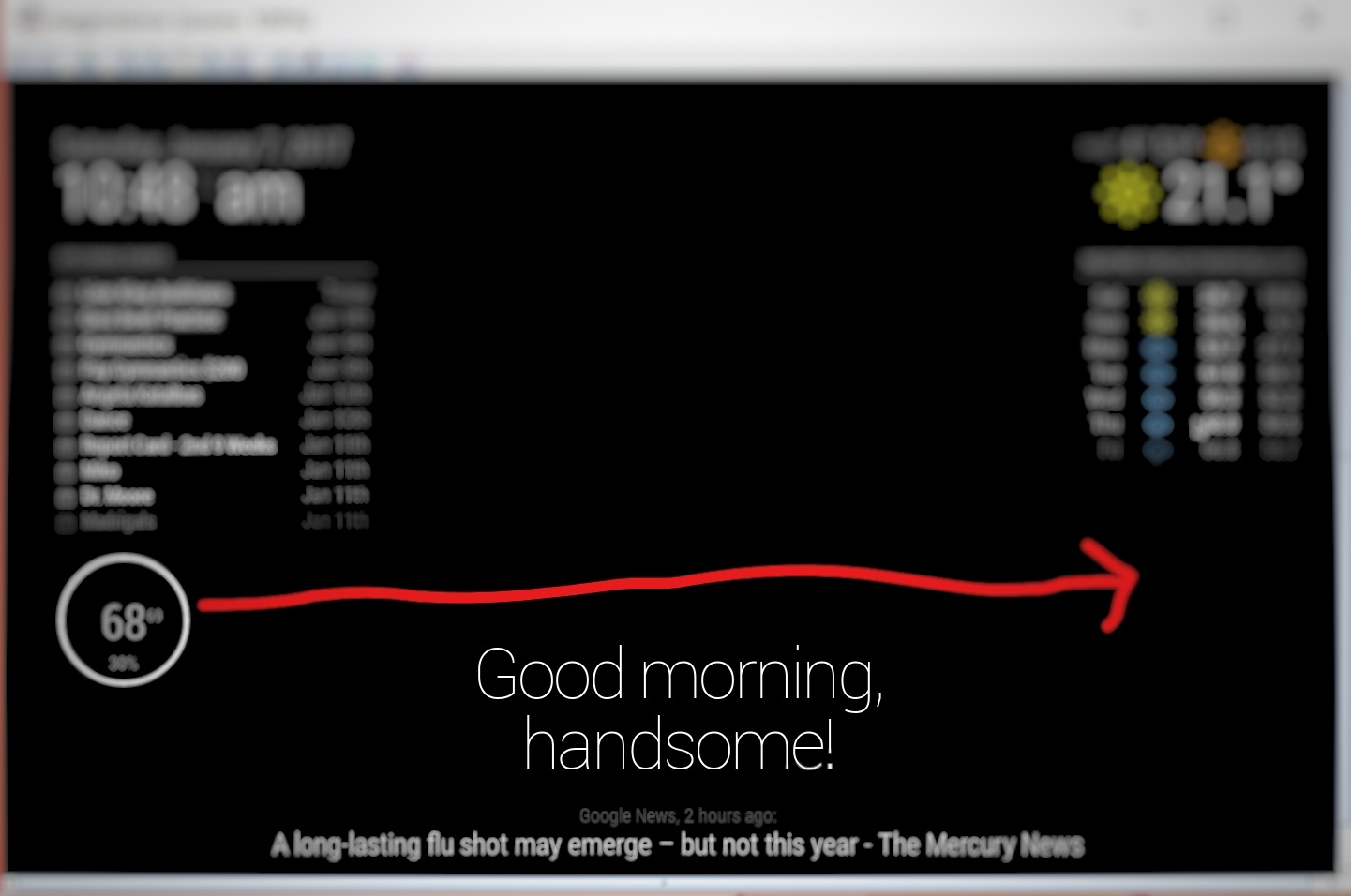

    My set up and modules are working perfectly. Thanks to all developers ! I’m just waiting for my 2 way mirror to be delivered. Anyway, how do I move this MM- Nest module to the right of the frame? If I try , “bottom_right” - it is too low. The perfect region for me is “lower_third” but I want it to the right instead of left.
    Thanks!!

      add
      .region.lower.third {
        text-align: right;
      To your custom.css file, should do the trick

        @broberg - thanks for the reply, I added it to my custom.css, but still no go. It is still at the same place.

          figured it wouldn’t apply to the div, but try this :
          .MMM-Nest {
            position: absolute;
            right: 0px;
