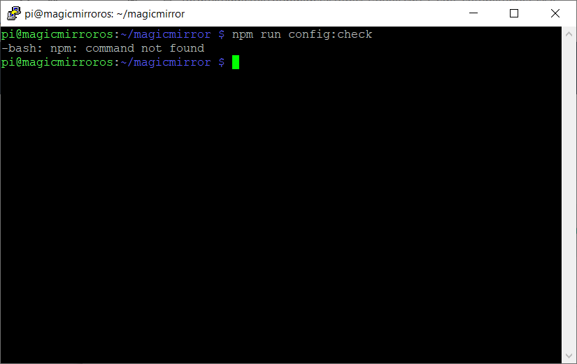

                      Yes this was going to be another question I wanted to ask as that doesn’t work on mine and I’m not sure why yet
                      I followed this site to flash a SD card https://github.com/guysoft/MagicMirrorOS
                      and when I run that I get this I guess I need to install that
                      alt text
                        sdetweil @mayfield
                        @mayfield
                        ah mmos…
                        then u have to run the command inside the docker container where mm is installed

                            mayfield @sdetweil
                            @sdetweil said in Can't edit compliments.js:
                            @mayfield
                            ah mmos…
                            OK cheers I’ll do some reading and thanks everyone for the help much appreciated
