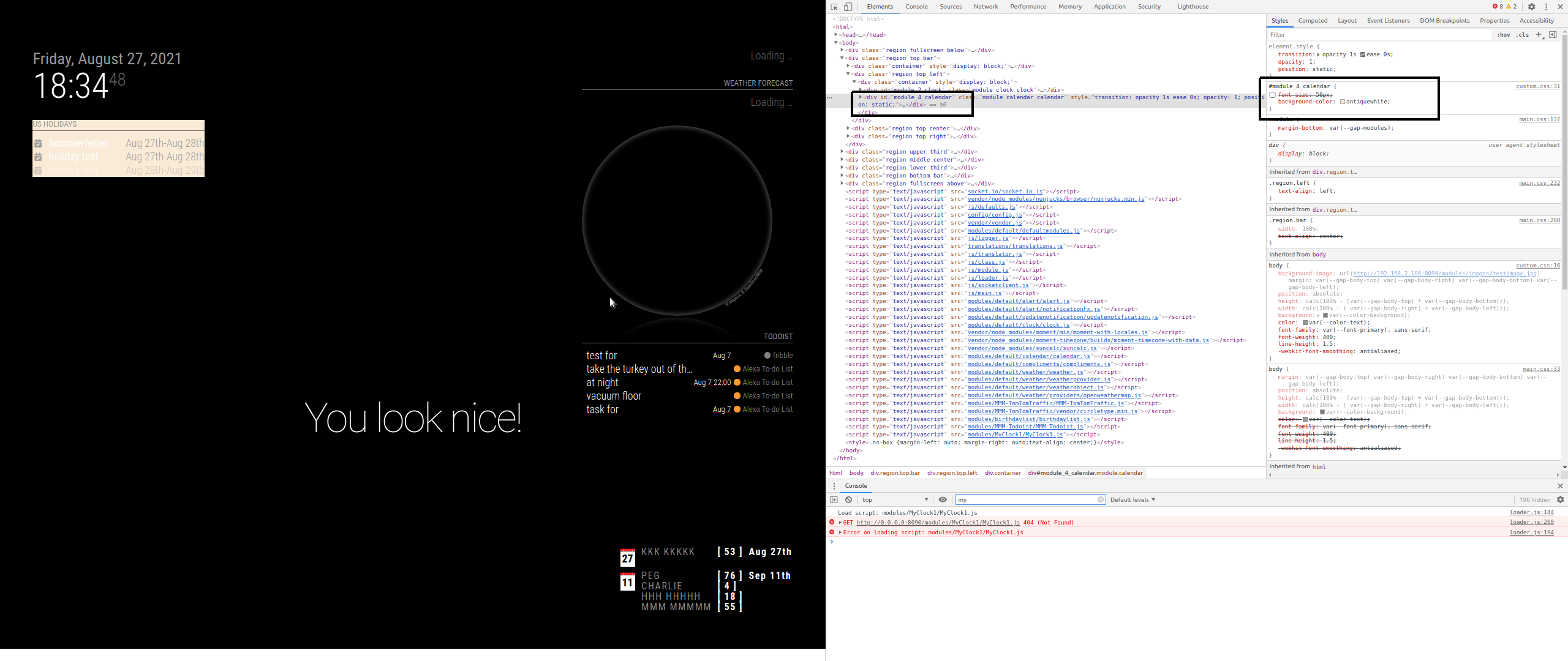

              @sdetweil This about duplicate modules and how to address them in config.js file. On my two calendar modules, how do I distinguish between the first and second modules in the config when module name is the same. The CSS name as you described above didn’t fly. The first module getRelative: 0,works as described but it is using the default getRelative: 6,in the second module
                sdetweil @ankonaskiff17
                @ankonaskiff17 use the module identifier
                look in the dev window, elements tab, and select the modules 1 at a time and see their identifier , use #id in custom.css
                note if u add/remove modules before this one, its ID will change
                ankonaskiff17A 1 Reply Last reply Reply Quote 0
                • ankonaskiff17A Offline
                  ankonaskiff17 @sdetweil
                  @sdetweil Are you saying to use that identifier in the config file too. I did that and it made the second module disappear.
                  I replaced module: 'calendar', with module: 'module_2_calendar',
                  This is the line in Developer Tools
                  <div id="module_2_calendar" class="module calendar calendar"
                    @ankonaskiff17 no. only in custom.css
                    identifier is created by mm
                      @ankonaskiff17 right, so #module_2_calendar
