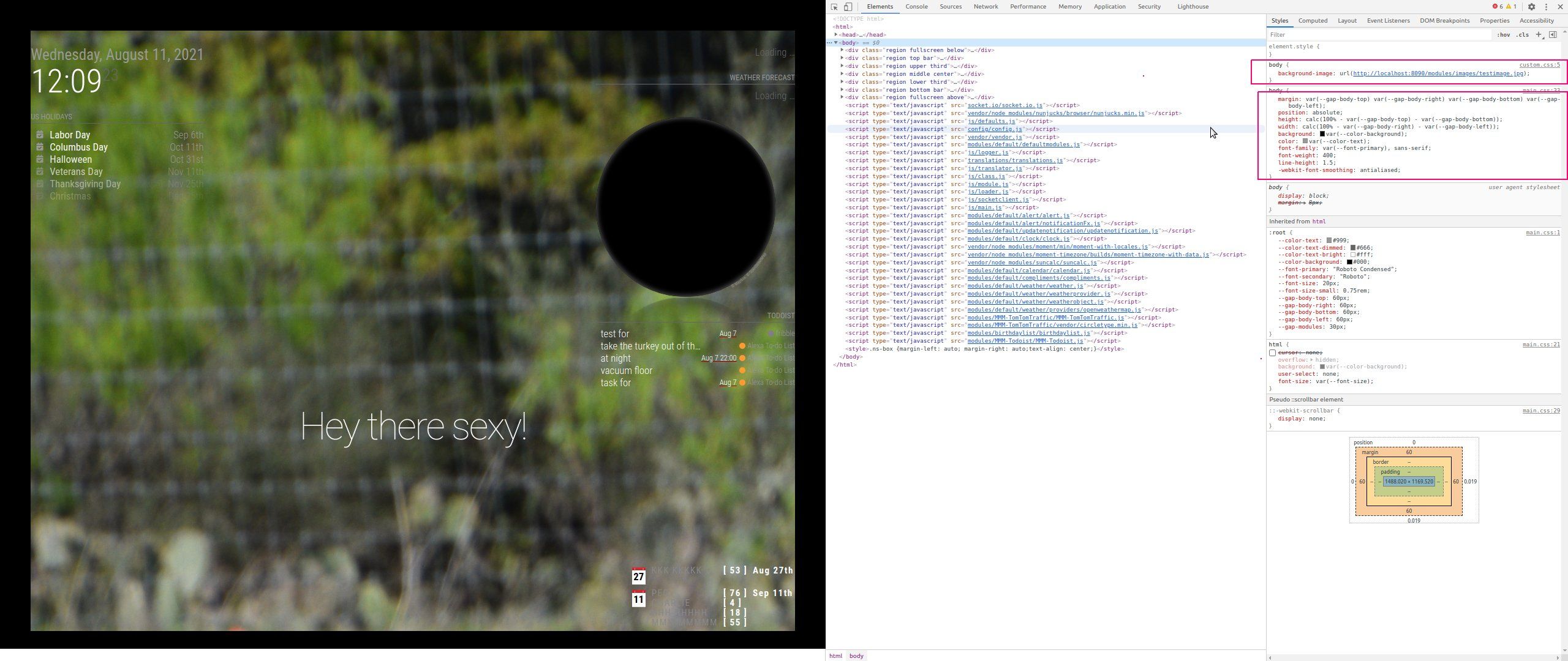

          @ankonaskiff17 so I added a body with a background image, using the MM web server in my custom.css
          body {
            background-image: url("http://localhost:8090/modules/images/testimage.jpg")
          and then started MM
          and got
          u can see the two body clauses on the right, top is custom.css (if u hover over the name it tells u where it came from)

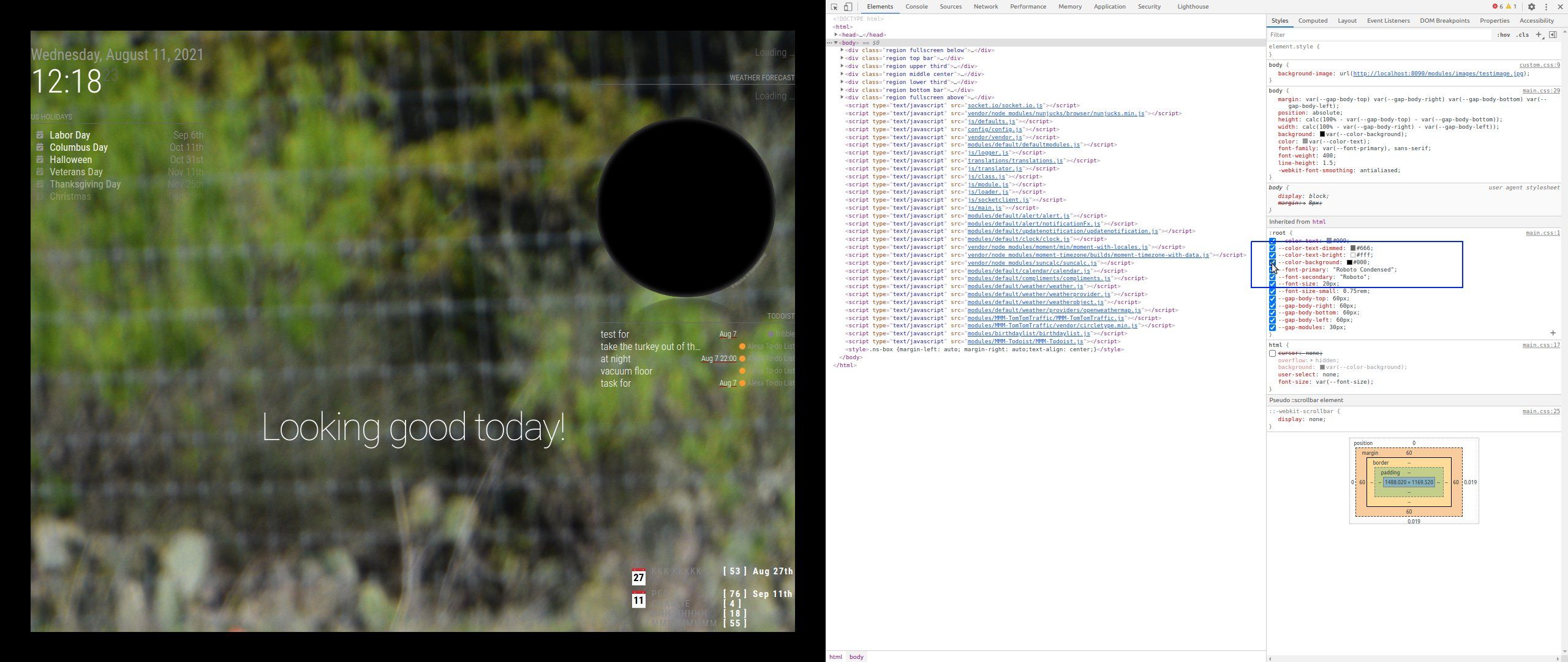

            and got
            notice border around pic

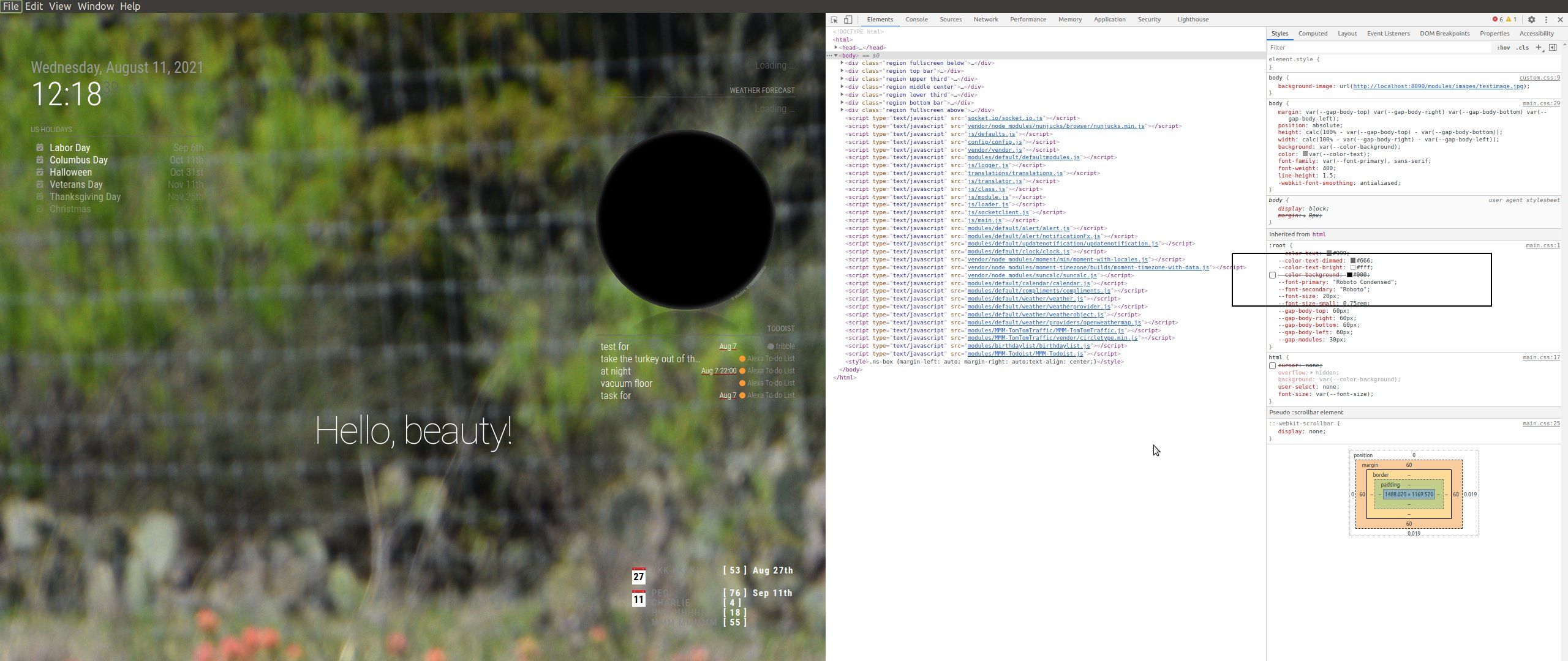

            then turned it off in the dev window
            border gone
