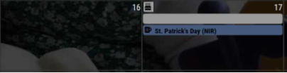

                My MagicMirror has been out of action for a few months now, mainly due to a kitchen renovation, but am looking at getting it back up and running.
                I’d previously had MMM-CalendarExt3 working with a few different calendars, notably a birthday calendar, where it would show an icon in the cell header.
                However since updating the MagicMirror software it no longer seems possible to do. Below is the module extract from config.js, and is what has been previously used. Now upon starting MM with this in place I’m told [ERROR] Your configuration file contains syntax errors :( ‘document’ is not defined.
                Anyone able to assist with what the issue is and how to resolve it?

                			manipulateDateCell: (cellDom, events) => {
                				if (Array.isArray(events) && events.some(e => e.calendarName === 'Birthday')) {
                					let dateIcon = document.createElement ('span')
                					dateIcon.classList.add ('fa', 'fa-fas', 'fa-fw', 'fa-gift')
                					dateIcon.style.color = 'cornflowerblue'
                					let header = cellDom.querySelector ('.cellHeader')
                					let celldate = header.querySelector ('.cellDate')
                					header.insertBefore (dateIcon, celldate)

                  sdetweil @bicolorbore586
                  @bicolorbore586 can you do
                  cd ~/MagicMirror
                  npm run config:check
                  does it produce the same error?
                  also do
                  node -c config/config.js
                  if it returns and displays nothing, then node did not detect any syntax errors.
                  edit: I can reproduce this
                    @bicolorbore586 add this to the top of config.js
                    var document;
                    I’ll open a bug report
                    I opened https://github.com/MagicMirrorOrg/MagicMirror/issues/3990

                      bicolorbore586 @sdetweil
                      @sdetweil config:check returns the same error
                      The node one doesn’t produce anything
                      Adding var document; to the config.js gives parsing error unexpected keyword ‘var’
                        @bicolorbore586 very first line
