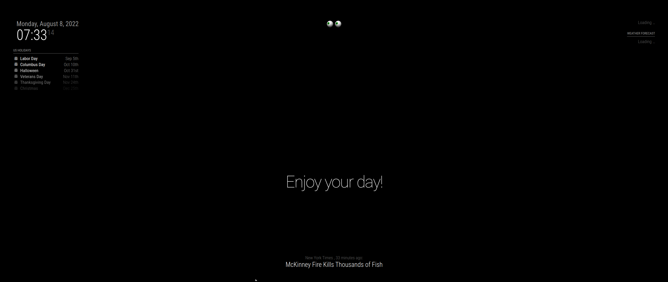

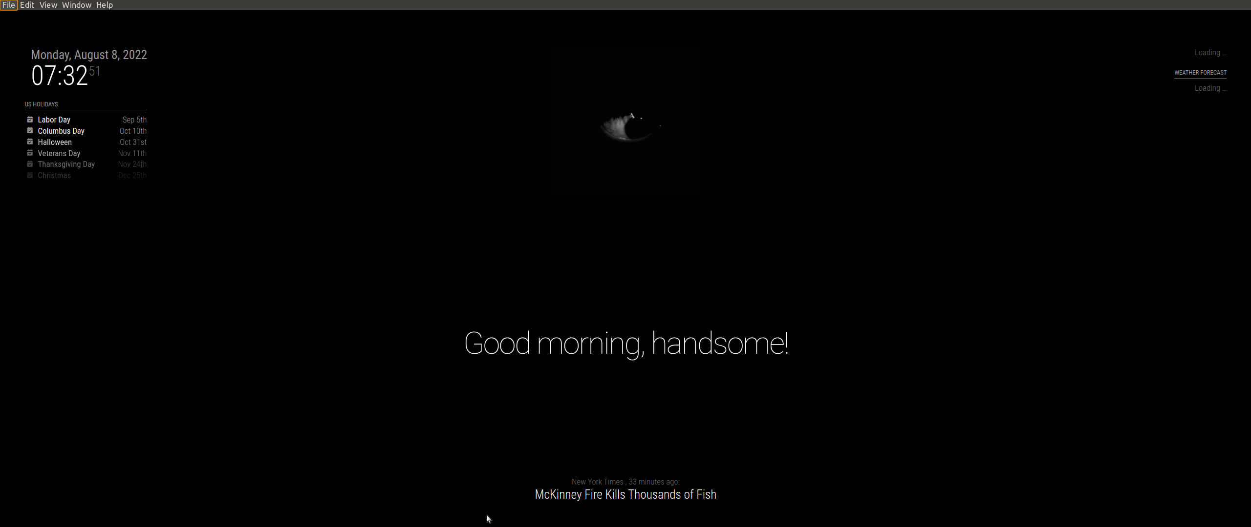

@MMNewby ok, I just installed the module and tested the two approches
- only style set
{ module: "MMM-EyeCandy", position: "top_center", config: { maxWidth: "75%", // Sizes the images. Retains aspect ratio. style: '1', // Style number or use ownImagePath to override style } },
with style 2
{ module: "MMM-EyeCandy", position: "top_center", config: { maxWidth: "75%", // Sizes the images. Retains aspect ratio. style: '2', // Style number or use ownImagePath to override style } },
this shows the images provided in the style selected…
- with ownImagePath set
{ module: "MMM-EyeCandy", position: "top_center", config: { maxWidth: "75%", // Sizes the images. Retains aspect ratio. ownImagePath: 'https://radar.weather.gov/ridge/lite/KCLE_loop.gif' // note I had to change the quotes when copy paaste from above } },
