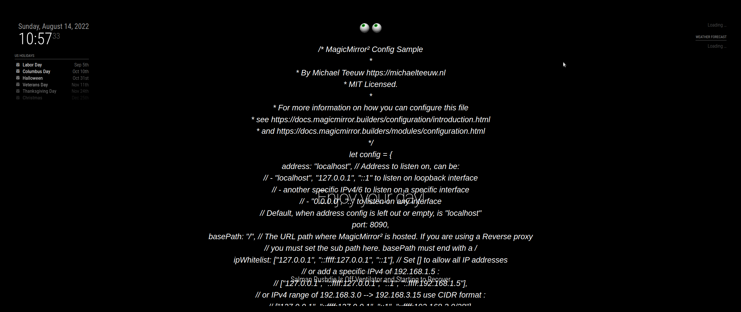

                              sdetweil @史新瑞
                              @史新瑞 no problem
                              here is my test config.js
                               	module: 'MMM-SimpleText',
                               	position: 'top_center',
                              			text: {
                              			  'value': 'Hello World!'
                              			fontURL: {
                              			  'value': 'Tahoma, Geneva, sans-serif'
                              			fontSize: {
                              			  'value': 'xx-large'
                              			fontStyle: {
                              			  'value': 'italic'
                              			color: {
                              			  'value': '#FFFFFF'
                              			filePath: {
                              				'value':"../../config/config.js"
                              and a screen shot
