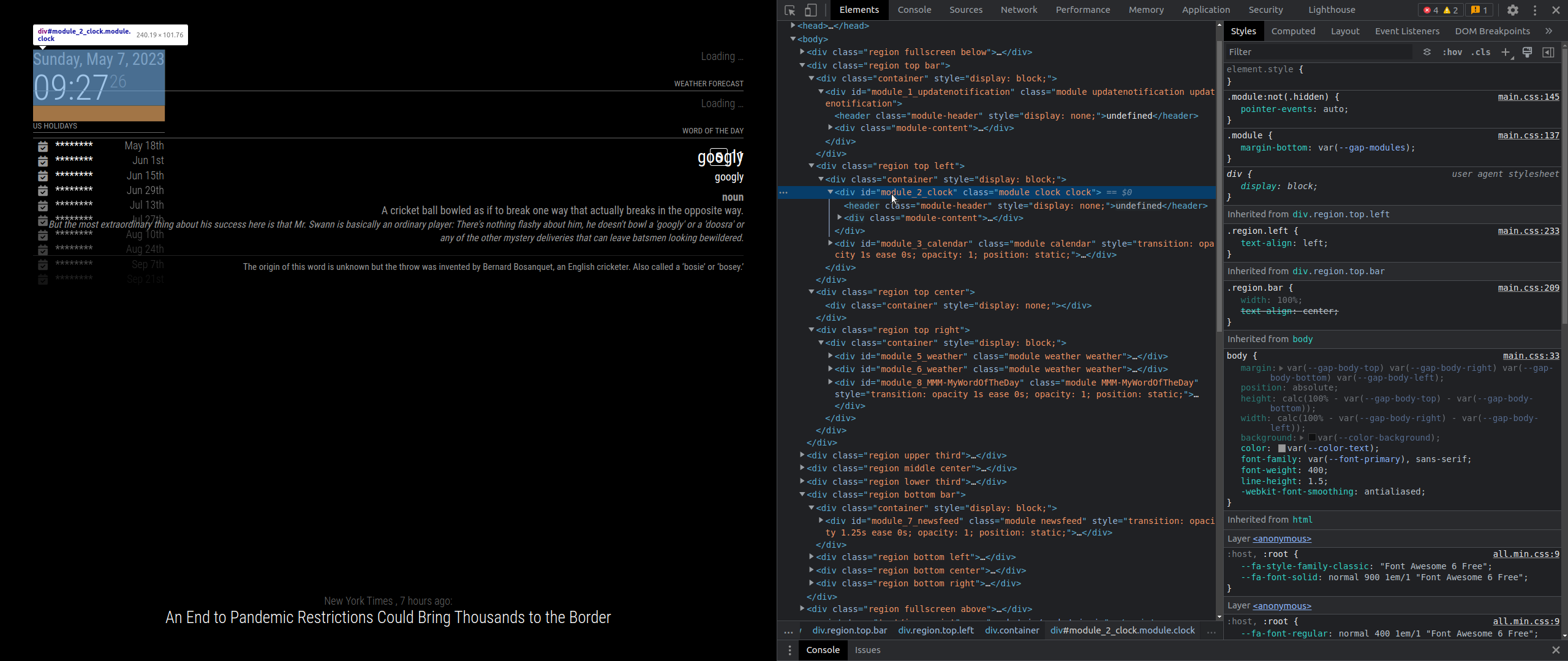

      @OWL in css the thing the left of the {, is called the selector clause
      it can contain all kinds of things and get very complex sometimes
      I use this one to help me remember or figure out a selector clause
      https://www.w3schools.com/cssref/css_selectors.php

          @OWL one thing to note on using the ID if you change the module order in config.js , the id changes…
          bugsounetB 1 Reply Last reply Reply Quote 0
          • bugsounetB Offline
            bugsounet Banned @sdetweil
            @sdetweil maybe classes in module config can help ;)
              sdetweil @bugsounet
              @bugsounet yes maybe too
