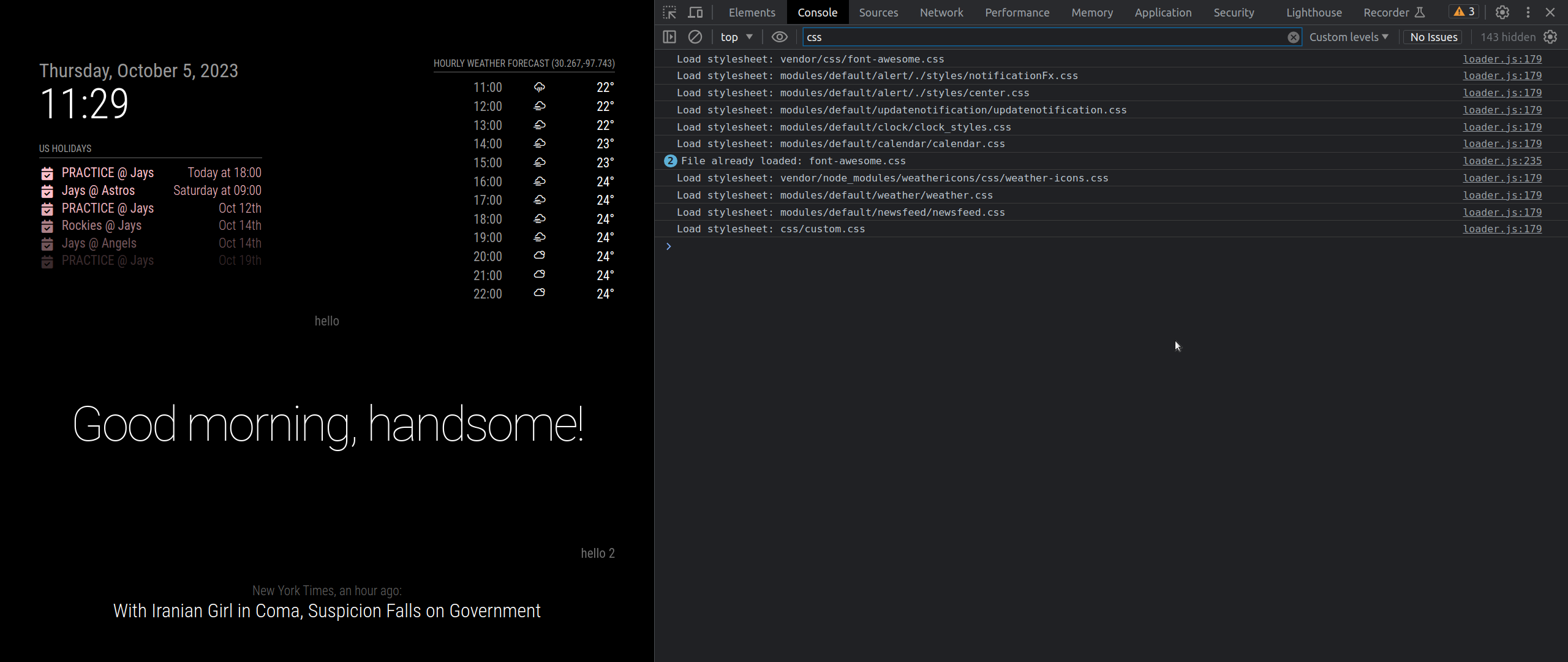

          @mbalmer open the developers window, ctrl-shift-i on the MM keyboard
          go to the console tab, and enter css
          you should see something like this

              sdetweil @mbalmer
              @mbalmer I don’t know why the animate.css is listed twice
              but it shows that custom.css was loaded successfully no error produced.
              So now we need to understand what’s in custom CSS and is it used properly.
              if you go to the elements tab you can use the little pointer to the left of the top left corner and you can use the mouse pointer over the content in the browser side to pick the element you want to look at when you click it will appear on the right hand side and you can see the style sheets CSS tree down the right hand side
