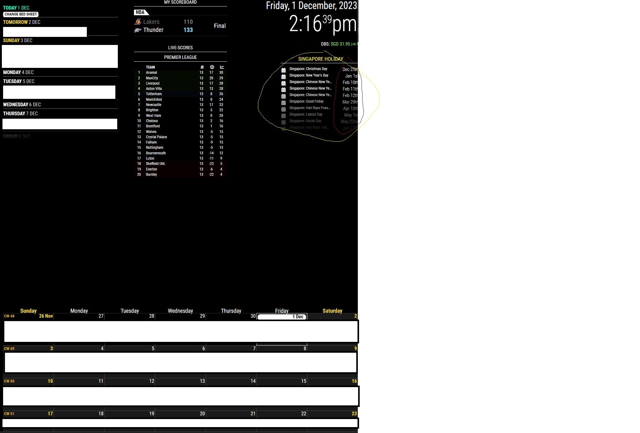

                  1a2a3a @1a2a3a
                  scratch that. managed to get cx3 and agenda to display correctly.
                  im now left with the overall date and the calendar module that doesnt sems to work…
                  i circled them in red both on the right. the red circle is abit light on the black background

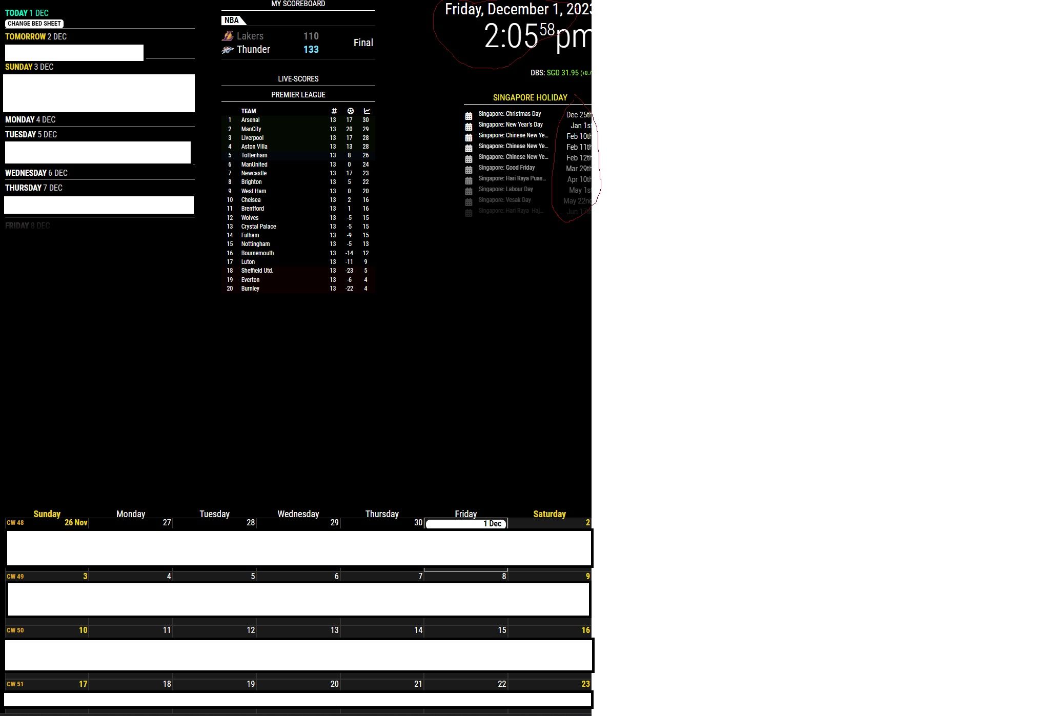

                  • 1 Offline
                    1a2a3a @MMRIZE
                    @MMRIZE ok almost there. overall date has been changed as well.
                    all thats is left is the holiday on the right…
