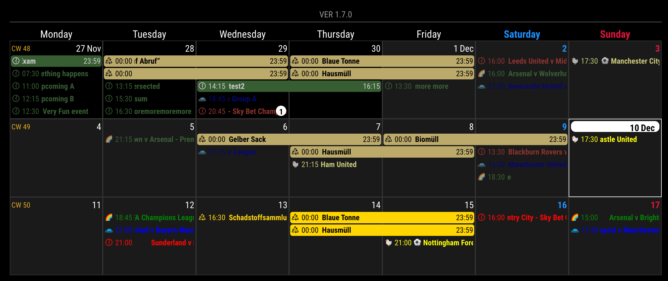

          The final result looks like this:
          That’s viewing it on a landscape monitor but it will eventually end up on one in portrait mode, hence the need to eliminate the dot and shorten the time.
          (Just trying to document this in case someone else is looking for the same answers.)
