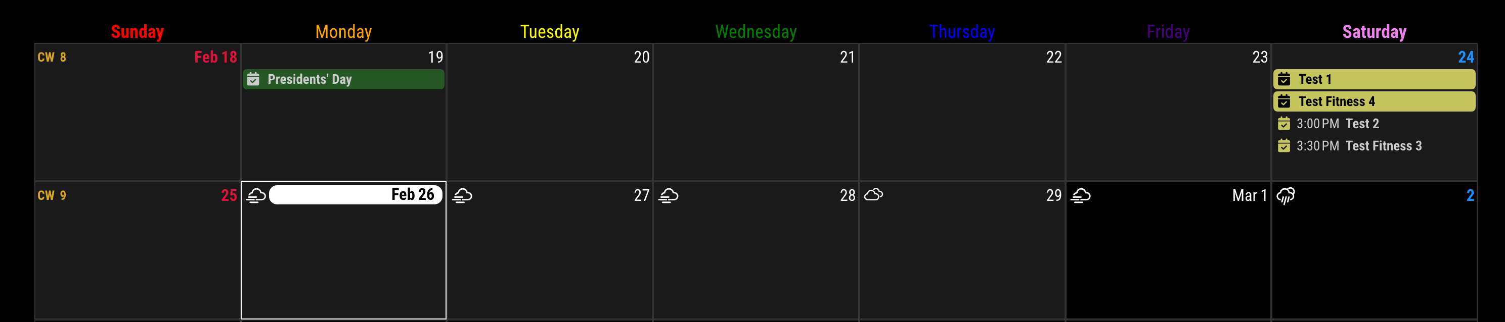

                      is it possible to change the colors of JUST the days of the week and not the dates?
                      I want to separate the colors of the sunday - saturday and the numbers, individually.
                      every time I change the css it changes the color of the whole column.
                        MMRIZE @greedyvegan
                        @greedyvegan
                        /* In your css/custom.css */
                        .CX3 .headerContainer .weekday_0 {
                          color: red;
                        .CX3 .headerContainer .weekday_1 {
                          color: orange;
                        .CX3 .headerContainer .weekday_2 {
                          color: yellow;
                        .CX3 .headerContainer .weekday_3 {
                          color: green;
                        .CX3 .headerContainer .weekday_4 {
                          color: blue;
                        .CX3 .headerContainer .weekday_5 {
                          color: indigo;
                        .CX3 .headerContainer .weekday_6 {
                          color: violet;

                          lol, last two requests
                          I got rid of the current and next months"Feb" & “Mar”
                          using dateParts.month.seq_0
                          but Jan wont leave, what do I do?
                          with the border radius and box shadow, I was able to give the calendar day numbers a circle behind them, the double digit numbers are circles, but the single digits are ovals; do you know how to keep it a circle?
                            MMRIZE @greedyvegan
                            @greedyvegan
                            .CX3 .week:nth-child(2) .cell:first-child .cellDate .dateParts.month {
                              display: none;
                              /* Intentionally, I showed the month in the first cell of the calendar */
                            .CX3 .cellDate .dateParts.day {
                              display: inline-block;
                              box-sizing: border-box;
                              text-align: center;
                              width: 22px; /* Fixed width */
                              height: 22px; /* W/H ratio should be 1 for circle not oval */
                              line-height: 22px; /* vertical centering */
                              border-radius: 50%;
                              border: 1px solid #fff;
                            • G Offline
                              greedyvegan @MMRIZE
                              @MMRIZE
                              ahhhh, the children
                              thank you very much.
