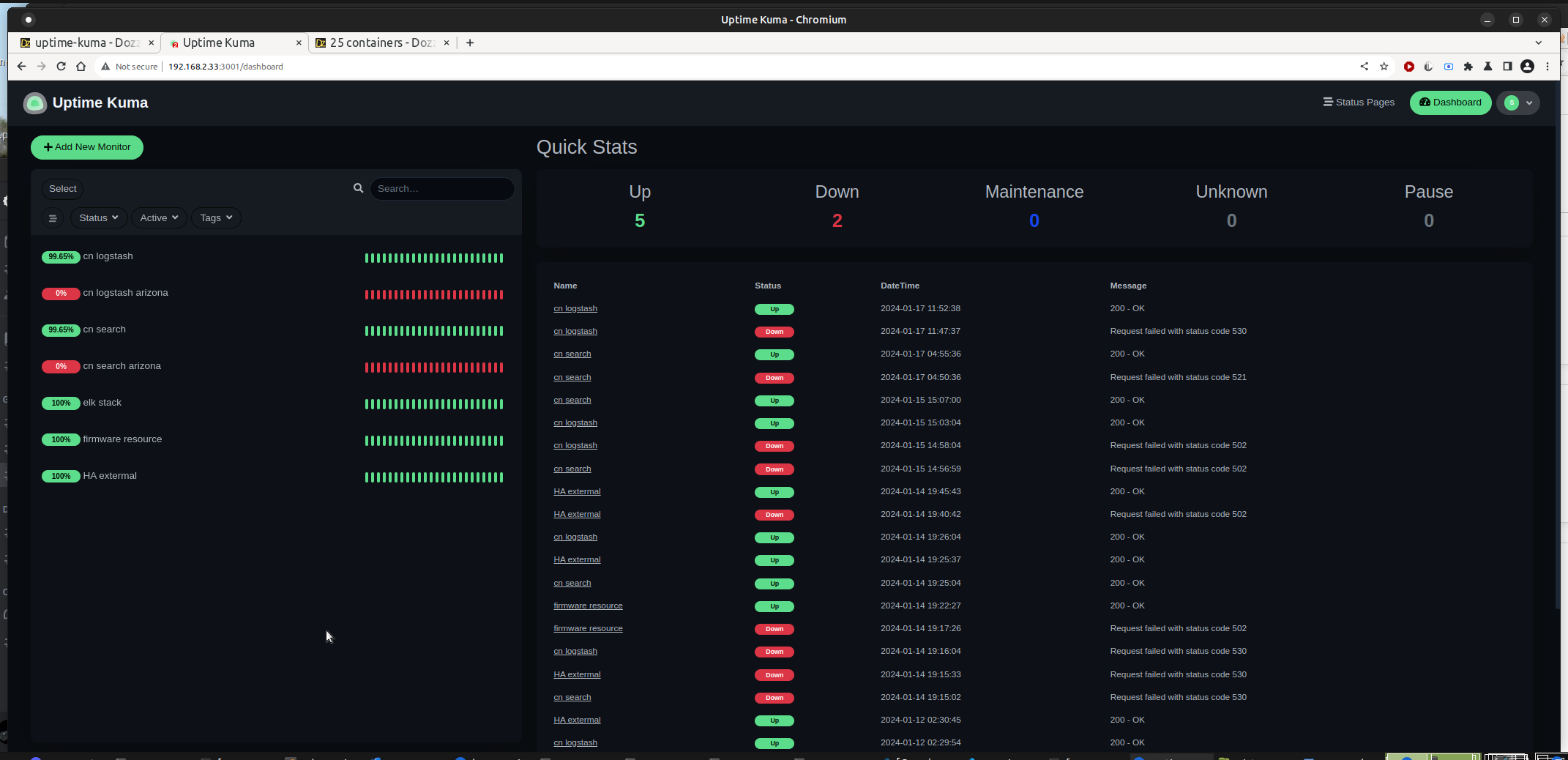

                            uptime-kuma can let you check and report on the status of different ‘apps’ web urls, connections… and send alerts
