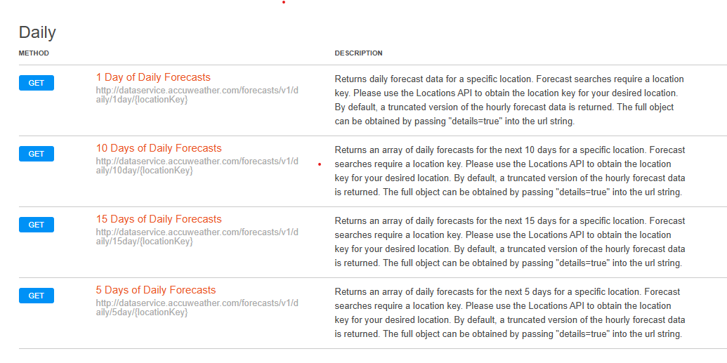

      Display of the days: I have set the line maxDailiesToShow: 8 from 5 to 8 in Config.js. Nevertheless, I still get 5 days displayed and not 8 days as desired. Also in the module js file 8 are entered. Why are only the 5 days displayed anyway?

            hrmax23 @svenpisa
