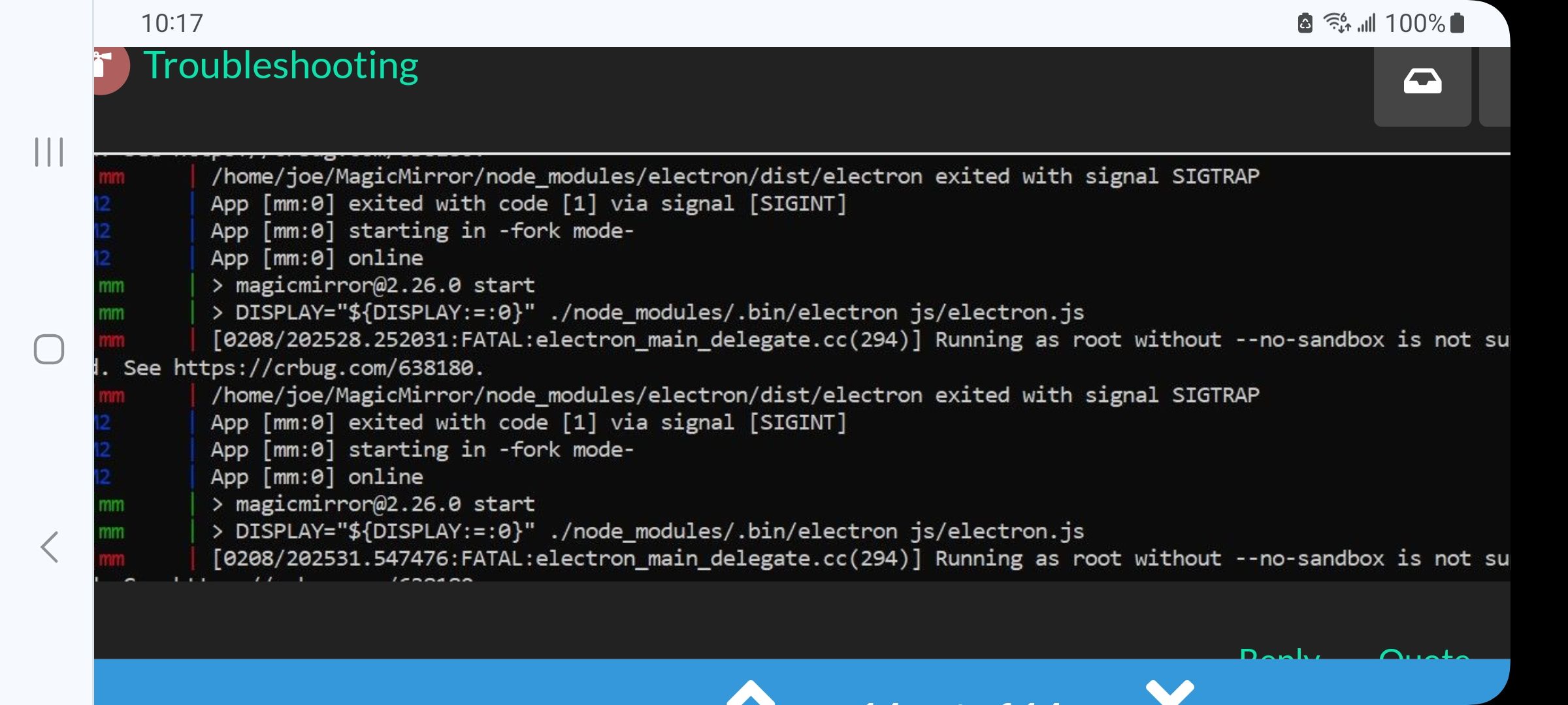

      @sdetweil I tried to follow the tutorial step by step. I’m not sure if that has be installing as root.
      This is what I see when I look at the log.
      This was the most I could screen shot, this log was very long.
        sdetweil @joebowers
        @joebowers /home/joe/MagicMirror/mm.sh no such file
        is that where the file is?
        does it have permission to execute?
        ls -laF mm.sh
        so,
        chmod +x mm.sh

          joebowers @sdetweil
          @sdetweil I was fooling around before coming to this forum for help. I believe I copied the mm.sh file into that folder, then later removed it. I put it back and saw this in the log:
          Then I realized I have a space after DISPLAY =, and there is no space between the two in the tutorials.
          So I fix that and tried running again, I see this:
          But no mirror software on the screen…
            sdetweil @joebowers
            @joebowers ok
            pm2 stop all
            pm2 flush
            then execute mm.sh
            cd ~
            MagicMirror/mm.sh

                    joebowers @sdetweil
                    @sdetweil In case it helps, I’m seeing this in the pm2 logs
                      sdetweil @joebowers
                      @joebowers why are you running at root?

                        joebowers @sdetweil
                        @sdetweil I have no idea. This is where I end up when following this tutorial step by step.
                        https://www.raspberrypi.com/tutorials/how-to-build-a-super-slim-smart-mirror/
                        Sometimes I I get this message: pm2 root.jpg
                        So I type in what is suggested to continue, I assume that makes me root??
                        I assume the tutorial, if followed exactly, should work.
                        Either it’s not fool proof, or I missing an important step.
                        Everything I’ve done is on a new raspberry pi.
