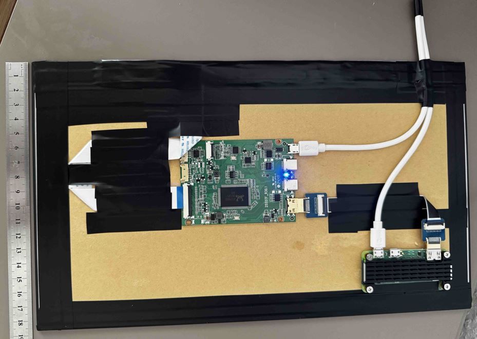

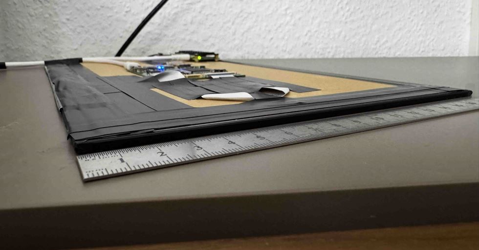

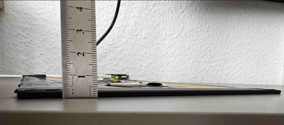

                      Dear community,
                      Thanks again for the helpful links and tips regarding my project. I’ve now more or less completed it. The only thing still missing is a suitable flat and thin frame—then it’ll be fully done.
                      I’m really impressed by how well it works with the Raspberry Pi Zero 2 W. Everything runs smoothly, and I’ve been able to install all the modules I need without any issues. The whole setup is now less than 1 cm thick. With the frame, it will probably end up around 1.5 cm.
                      Unfortunately, I still have to run two cables—one for the display board and one for the Zero2.
                      Once again, thank you so much for the support! This project was a lot of fun and now gives us a great overview of daily tasks, appointments, current traffic conditions, weather, and more.
