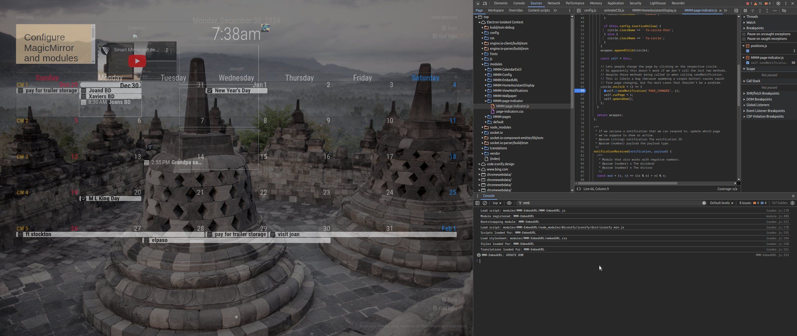

                  sharkbait @MMRIZE
                  @MMRIZE Thank you for the taking the effort to provide me with the set of code. I’ve tested it and it works wonderfully.

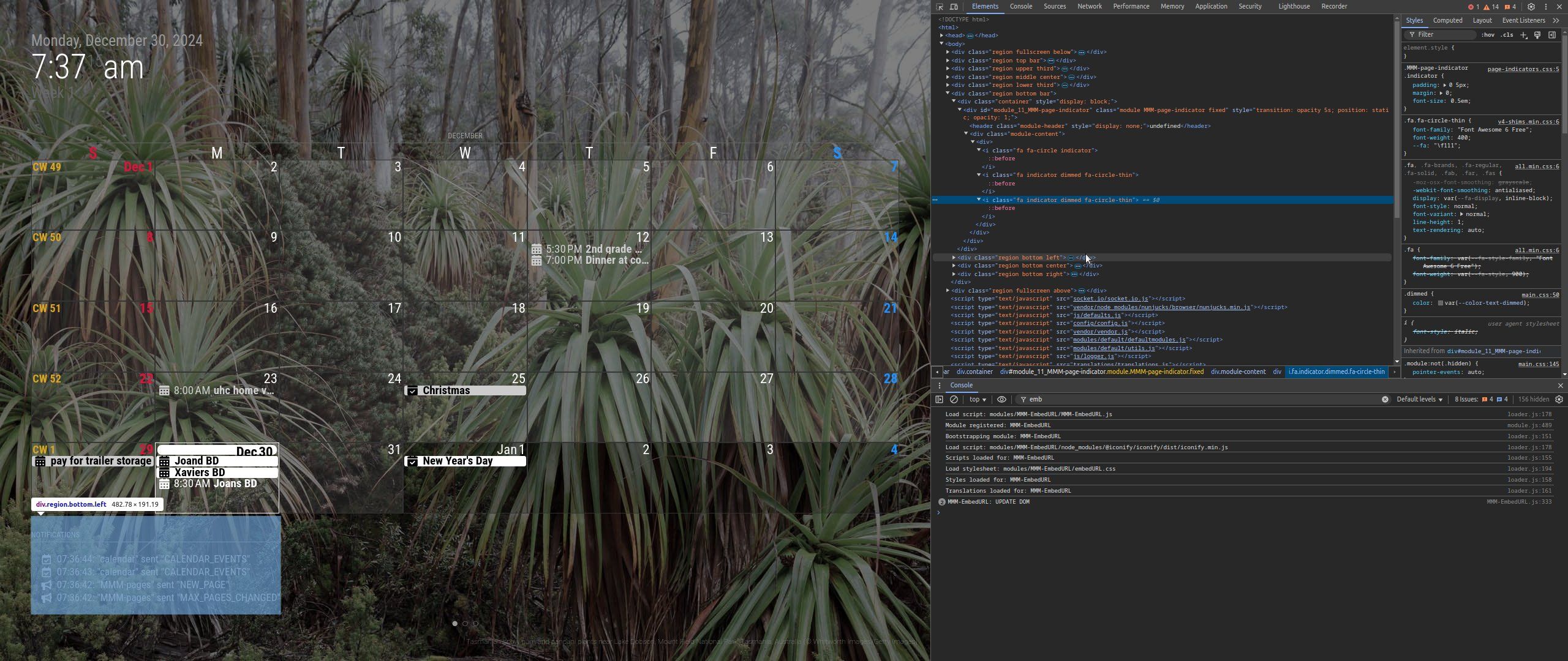

                    sharkbait @MMRIZE
                    @MMRIZE I tried to implement this CustomInjection code but the rendered display turned out like this ![alt text]https://drive.google.com/file/d/1OUJ3EBz1CNMVqA9ds7kQhc4sTuovUoUA/view?usp=sharing.
                    My setting in config.js is as follows:
                    module: “MMM-CustomInjection”,
                    position: “bottom_bar”,
                    Instead of buttons, what I see is just the module name (MMM-CustomInjection, and below that module_5_MMM-CustomInjection).
                    This is definitely a more polished solution, but I’m not sure why the display could not be rendered.

                        MMRIZE @sharkbait
                        @sharkbait
                        MMM-CustomInjection doesn’t need to be positioned because that module works on background.

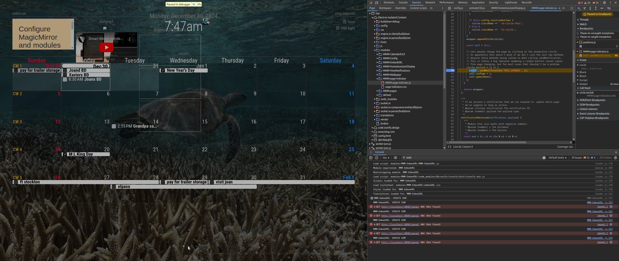

                          sharkbait @sdetweil
                          @sdetweil I added this entry to custom.css:
                          html {
                            cursor: default;
                          For config.js, my settings for “MMM-CalendarExt3”, “MMM-pages” and “MMM-page-indicator” were as follows:
                              you can expand the sections to show the buttons (<a)
                              now select the sources tab, expand modules in left nav, select MMM-PageIndicator, select MMM-PagIndicator.js, its source should appear in the right pane
                              scroll down and click on the number on line 66, it should highlight, like this
                              now click one of the page indicator buttons… mouse or finger
                              it should show and stop on the line 66 instruction
                              if it did then it is operating
                              if it didn’t… hmm…
                              if it stopped, click the line 66 again , and the highlight will be removed, and then push the blue arrow on the top right, to continue the application
