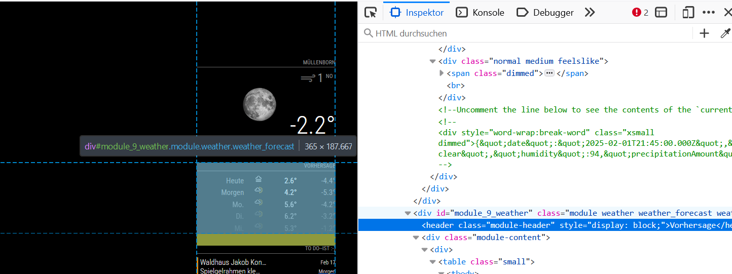

              Additional question as CSS rookie:
              I’ve tried to identify the object of the header.
              how can I address this correctly?
              Sorry, I’m not able to figure this out.
              My best guess is
              .weather_forecast .header {
                border-bottom-width: 0px;
                color: black;
                font-size: 0px;
              but this doesn’t work.
              How do I make this right?
              Thanks!
              Ralf
                sdetweil @rkorell
                @rkorell .module_header
                  @sdetweil thanks.
                  But this seems not to work.
                  .weather_forecast .module_header {
                    color: black;
                    font-size: 0px;
                  changes at least not, what I would like to happen: not visible regardless of content, so text color black and line below not visible, as well - line thickness (border-bottom-widht) 0 …
                  What I’m doing wrong?
                  Am I on the wrong properties?
                  Thanks again,
                  Ralf

                      sdetweil @rkorell
                      @rkorell module header not displayed?
                          display: none;
                      Before I was giving you the classname of the header element
                        sdetweil @rkorell
                        @rkorell the debugging:true was my choice to provide info during execution cycle vs startup.
                        It’s not relevant for other modules
                        There is an option in weather, by default it will append the location(from the api data) to the header.
                        You can turn that off
                        appendLocationToHeader:false,
                              display: none;
                          sorry doesn’t work, either :-(
                          I’ve even copied your phrase to avoid typos - nothing happens.
                          Sounds feasible and plausible, but don’t do the job…
                          Ive tried
                          .weather  .module_header {
                              display: none;
                          Didn’t work, too…
                          really strange…
                          Thanks for any additional idea…
