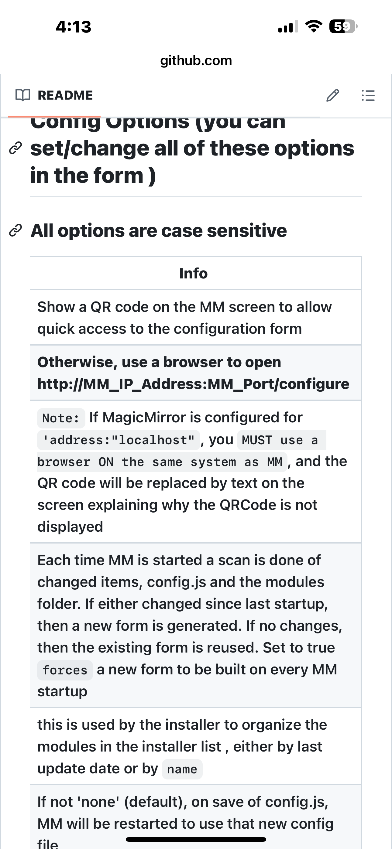

                        sdetweil @nowayto
                        @nowayto yes, the doc mentions this, and if you had set
                        showQR:true
                        it would have displayed a message about localhost
