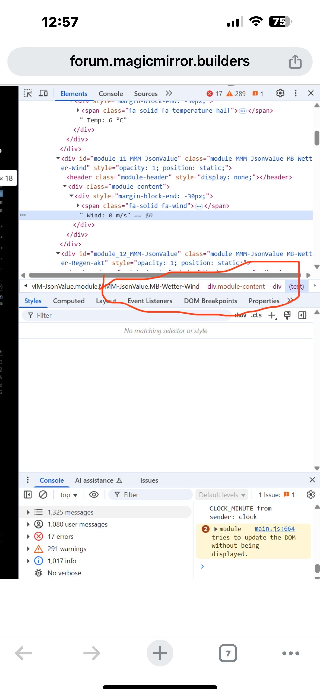

                when you select the element in the dev window
                down at the bottom is the selector clause prototype

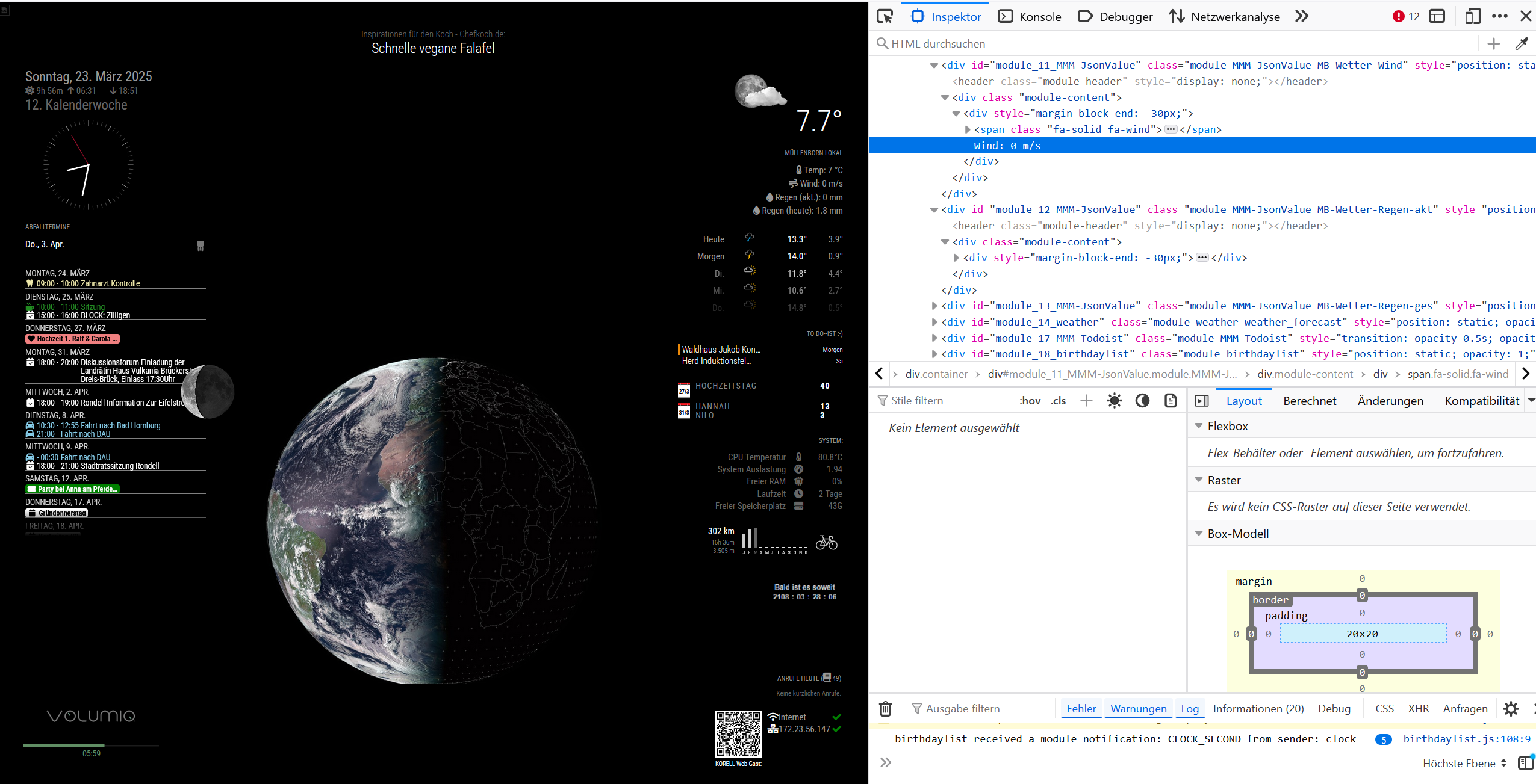

                    rkorell Module Developer @rkorell
                    This is complete view in Firefox Browser

                      sdetweil @rkorell
                      @rkorell there is an extra close div after the span
                      where does it open
                      R 1 Reply Last reply

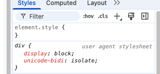

                              sdetweil @rkorell
                              @rkorell prototype
                              S R 2 Replies Last reply
                              Reply Quote 1
                                @rkorell maybe that will work
                                if you change it in the input area, does change

                                        sdetweil @rkorell
                                        @rkorell said in CSS modifications on a module which has no own css styles?:
                                        .MB-Wetter-Temp .module-content div {
                                        color: “fuchsia”;
                                        SO close… the color is NOT in quotes (in css)
                                        sorry I missed that before
                                        .MB-Wetter-Wind .module-content div {
                                          color: blue;
                                        here I am using the dev window to override the blue to red… see the top right of the right column , note that the one from custom.css (just below), is strikethru to say it is overridden by something higher up
                                        if you uncheck the checkbox in front of the color:red; it will disable that value and the strikethru will go away and the text will be blue
