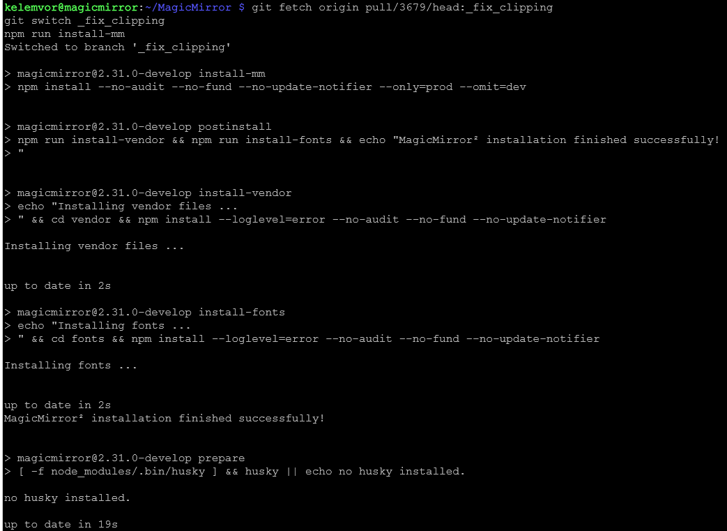

            @Kelemvor did you install the clipping fix
            https://forum.magicmirror.builders/topic/19282/version-2.30.0-calendar-fix-for-clipping-broadcast-events
            • K Offline
              Kelemvor @sdetweil
              I did now:
              But it didn’t seem to have any effect.
