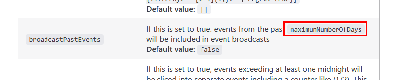

      I think I fixed it and I Just found a typo in the official documentation:
      On this page:
      https://docs.magicmirror.builders/modules/calendar.html#configuration-options
      The first instance of broadcastPastEvents is wrong.
      It should say pastDaysCount, not maximumNumberofDays,
      Anyway, I set broadcastPastEvents to True and PastDaysCount to 1. It seems to be showing now. I’ll know more tomorrow afternoon.
