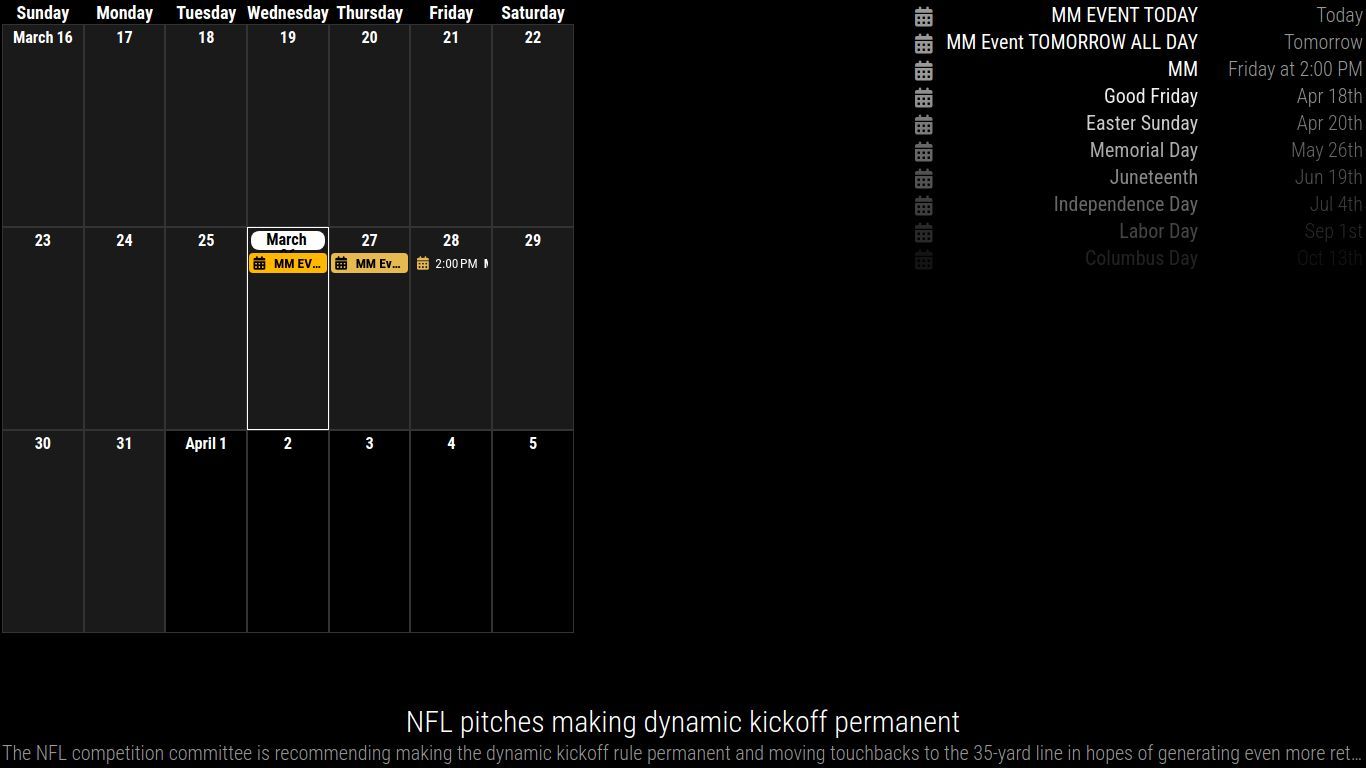

      And here’s what’s on my MagicMirror:
      I’m guessing I’m missing something simple, but I just don’t see it. I appreciate everyone’s help!

            @sdetweil Thanks so much for the reply! I didn’t know about that fix and have now applied it. However, it is still only broadcasting future events. I only get the 2 events (today and tomorrow). Nothing from the 24th-26th.
