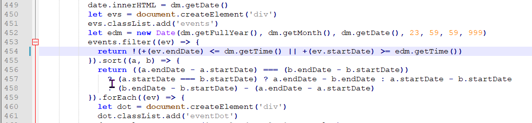

                  • K Offline
                    Kelemvor @Kelemvor
                    Maybe something in this section if I’m deciphering things correctly…
