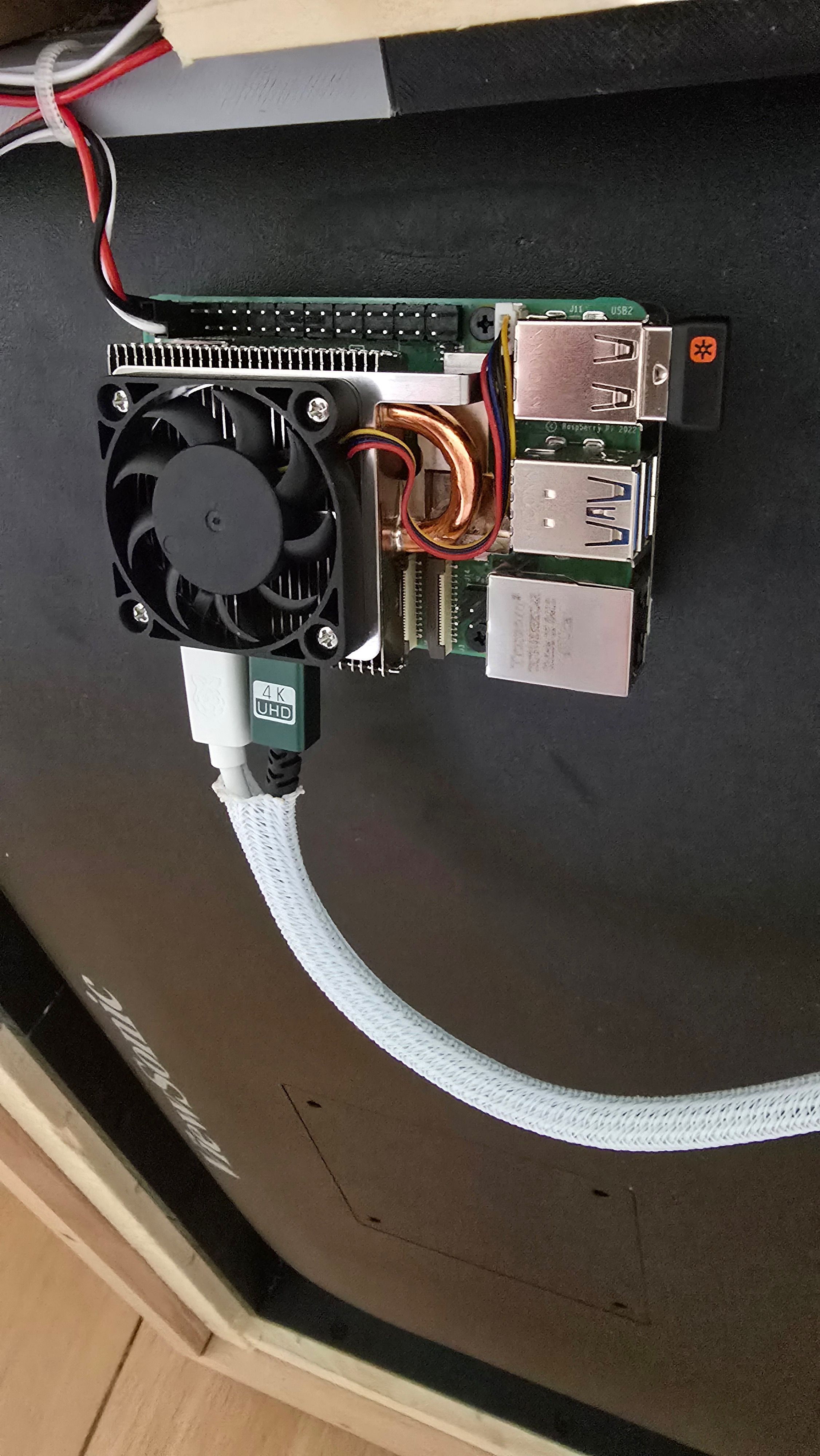

                  In the meantime a GeeekPi Ultra Thin ICE Tower Cooler is arrived and just installed.
                  Fan is bigger than Pi - looks weird.
                  After 20 minutes temperature is at 52°C nothing to hear.
                  Keep you posted…
                  Thanks for your feedback so far!
                  Ralf
                    sdetweil @rkorell
                    @rkorell that is a beast!!!
                      @sdetweil :-) indeed ….
                      (Fits millimeter-exactly behind the mirror no more space left…)
                      But seems to work.

                          Than I‘m on the right way - still works today :-)
                          Temperature was 45°C today in the morning - was at 56° everytime before …
                          So even passive cooling seems to be much better.
