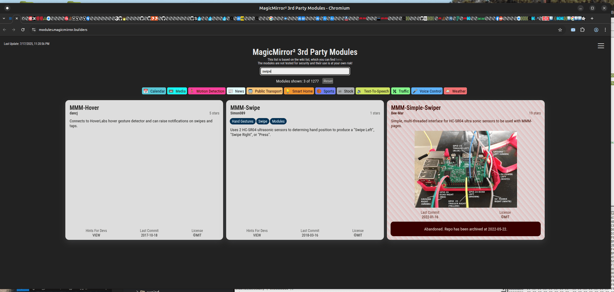

                          sdetweil @seabass
                          @seabass neither of those modules support swipe
                          MMM-Swipe maybe but it requires hardware sensor
                            sdetweil @seabass
                            @seabass you can use the MMM-PageIndicator module to put buttons on the screen to provide manual nav (and you can customize the buttons using css)
                            its not swipe tho
                            also, are you talking mouse swipe, finger swipe, hand waving swipe?
                            they all have different requirements for implementation
