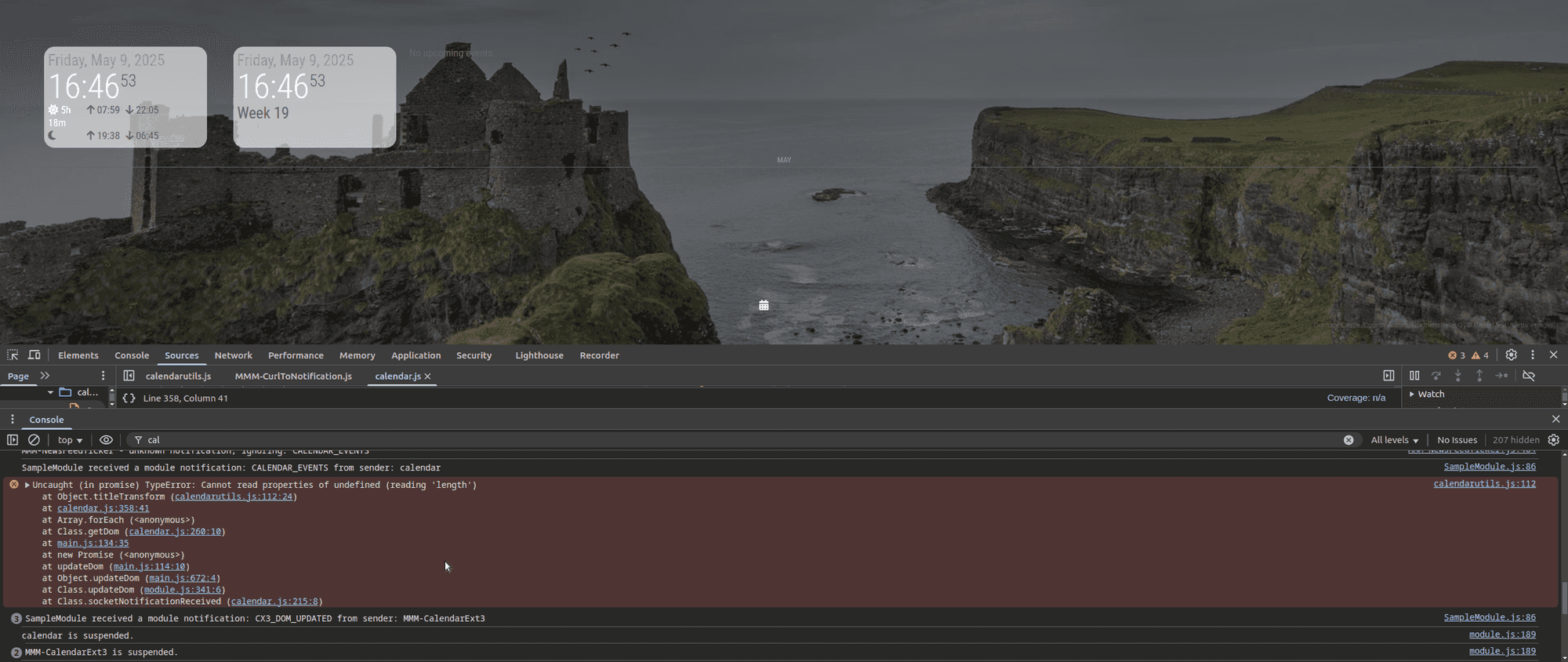

          But when I refresh the browser whithin the Kalender „Familienkalender“ is no entry anymore but the word „loading…“ but nothing new is shown after a while.
          What could this circumstance cause?
            sdetweil @pauabaer
            @pauabaer that means there was an error
            open the developers window
            ctrl-shift-i
            select the console tab
            put cal in the filter field
            and you may see the error , I changed to match one of my cal event titles
            but the regex doesn’t work…
            P 1 Reply Last reply Reply Quote 0

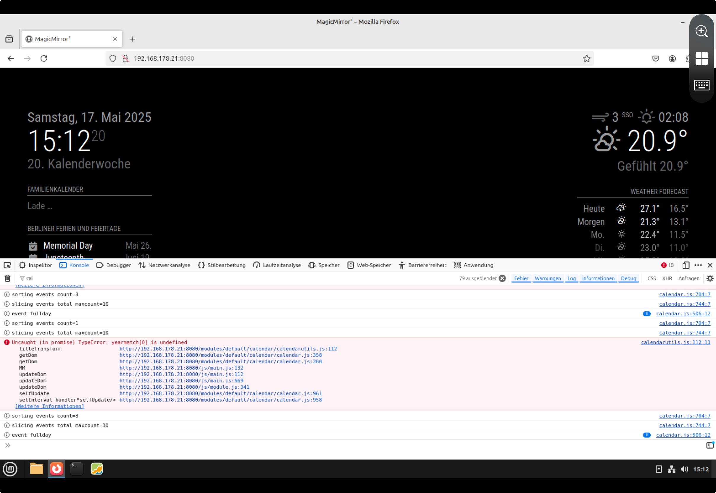

            • P Offline
              pauabaer @sdetweil
              Thanks for helping.
              I tried to figure out. Went to the console tab and put the filter on cal.
              I get an error your yearmatch is that right? But I don’t know how to deal with it. Can you give me a hint?
                sdetweil @pauabaer
                @pauabaer its a regular expression to extract the parts of the date,
                i would use the developers window sources tab to locate that code in the calendar module and examine the data it is working with
                i might get a chance later today

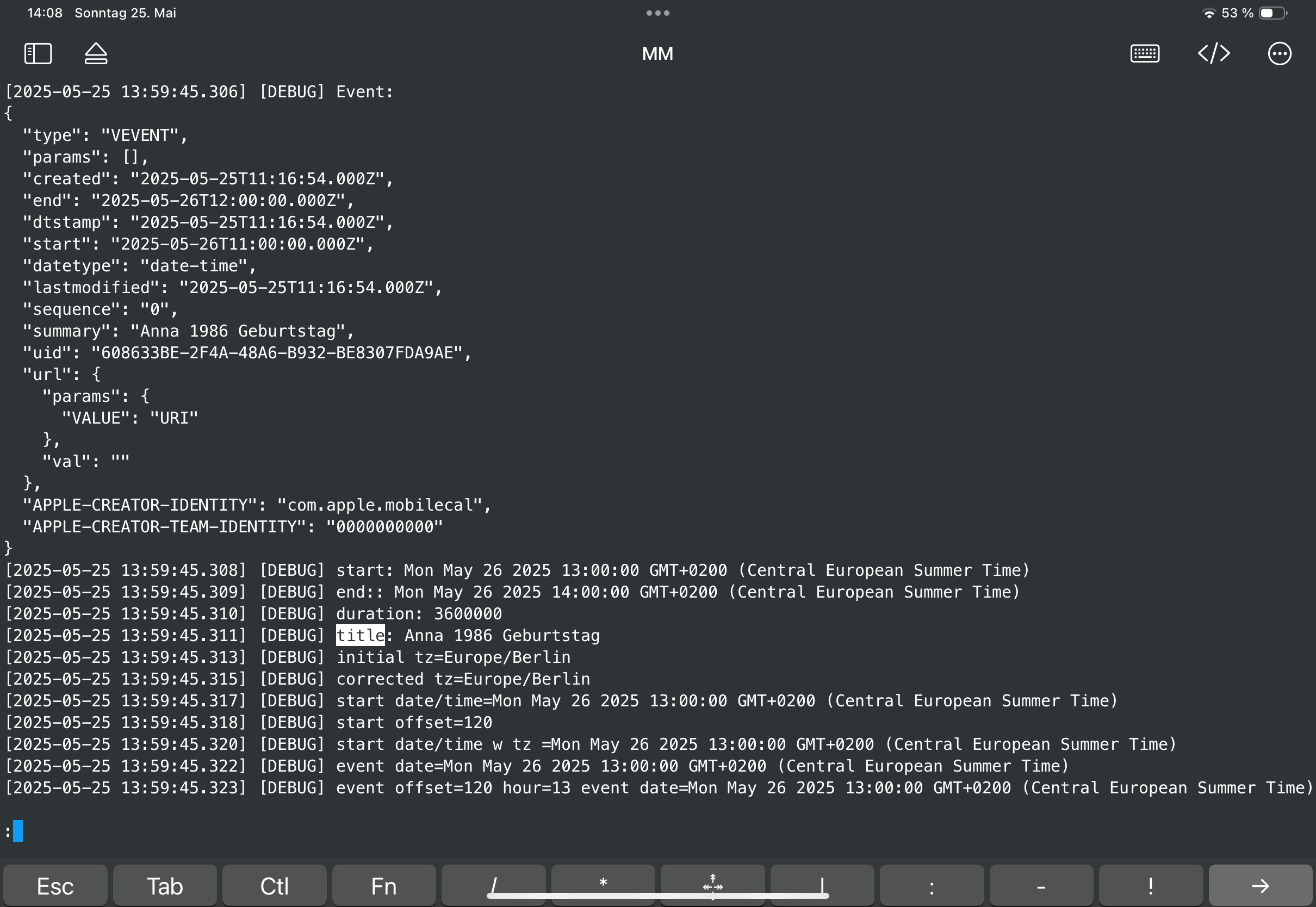

                  sdetweil @pauabaer
                  @pauabaer could you add
                  ,"DEBUG"
                  to the config.js logLevel property
                  as well as your transform
                  and run MM with (stop pm2 version , with pm2 stop MagicMirror)
                  npm start >somefile.txt 2>&1
                  so we can see the actual text of the event
                  (watch out, the log output contains the COMPLETE text of the calendar url)
                  I only need the text of the event… (it supposedly has the date in it)
                  • P Offline
                    pauabaer @sdetweil

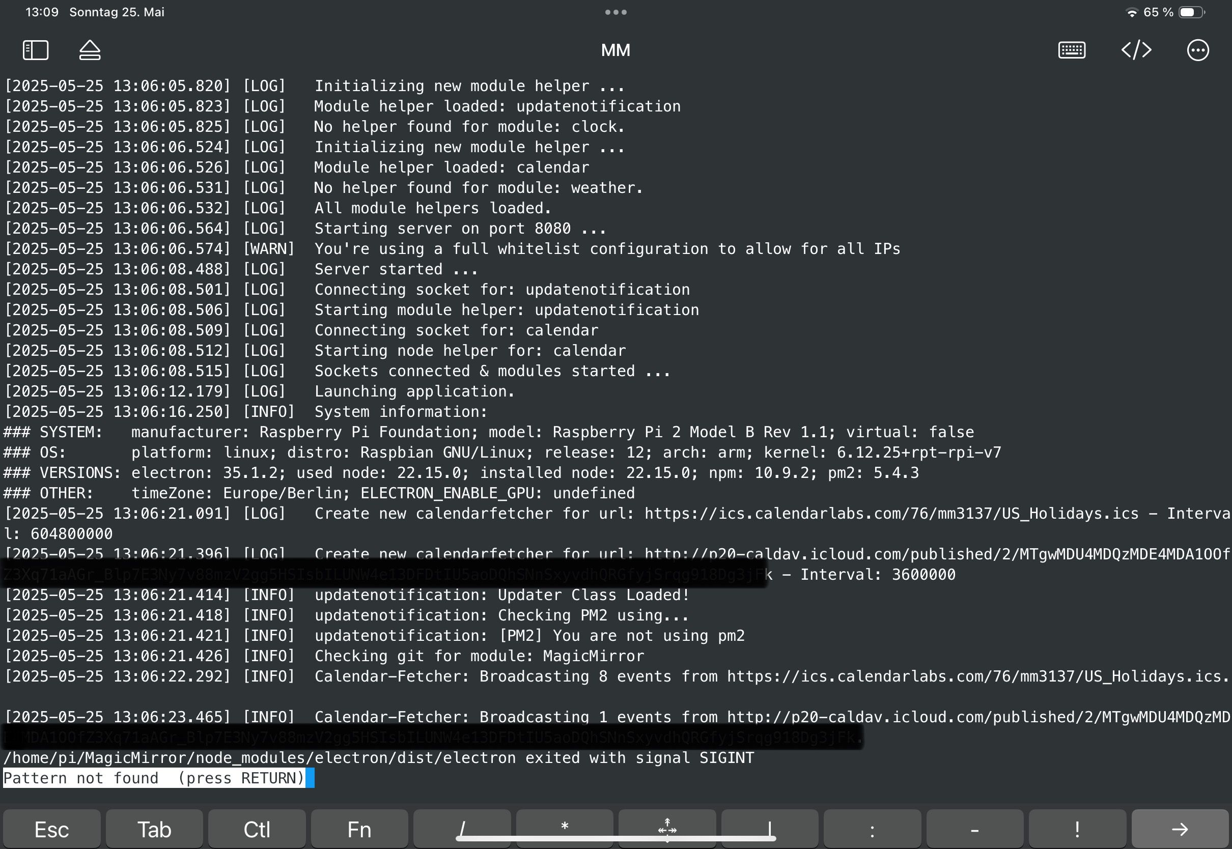

                    Finally I got some time to test. See the pic below:
                    I got the message that there is one entry but no title is shown. Did I do something wrong?
                      sdetweil @pauabaer
                      @pauabaer you didn’t add the debug setting to config.js
                      the transform happens in the front end, the backend (node_helper) gets the events from source and formats them for frontend.tye log you showed is from the backend

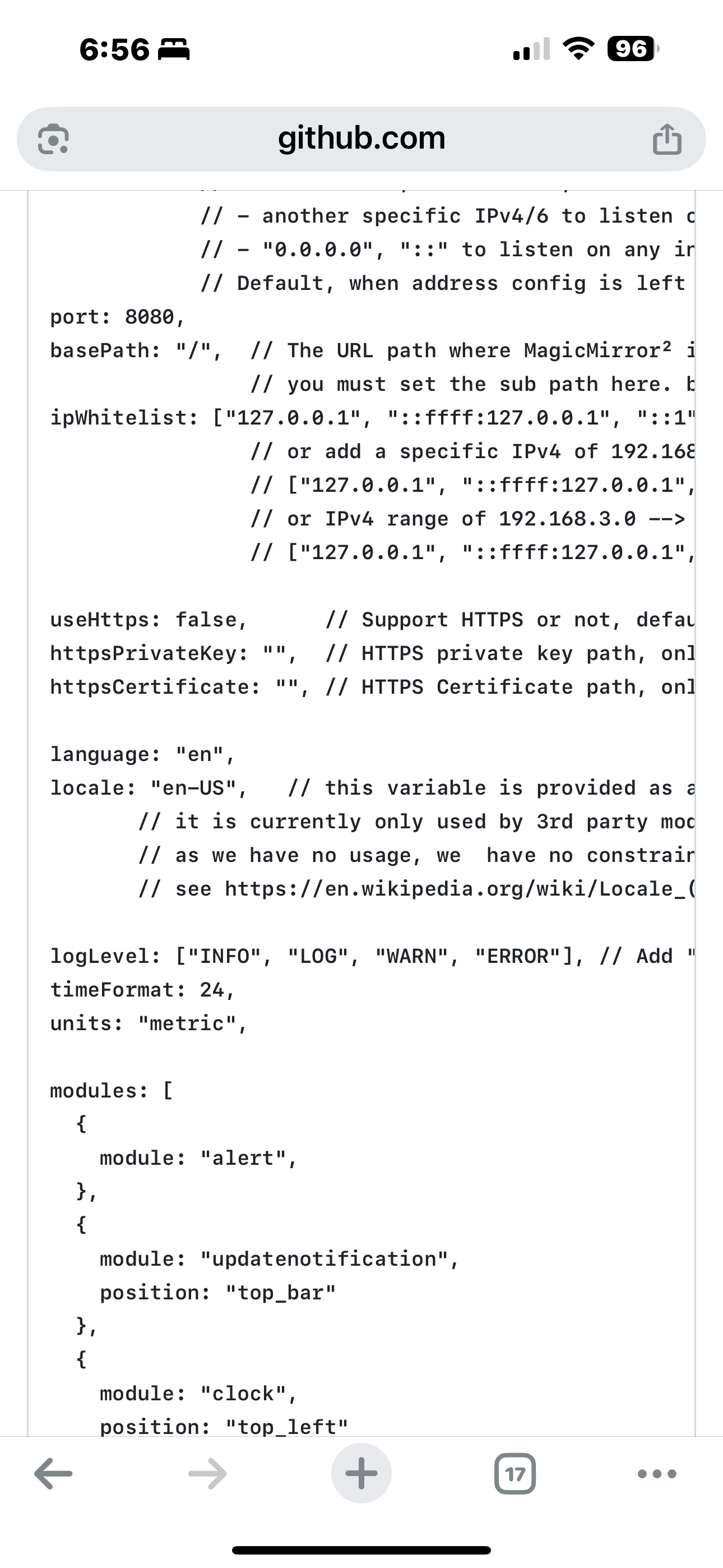

                          sdetweil @pauabaer
                          @pauabaer logevel is above the modules list
                          its not a module setting

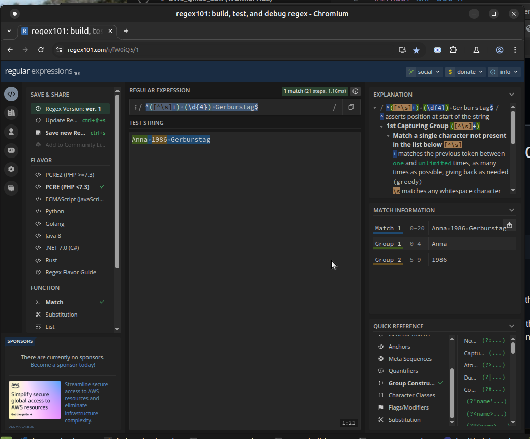

                              sdetweil
                              your search regex is wrong,
                              ^(.+) (\\d{4}) Geburtstag$
                              its captures EVERYTHING from the start… and there is nothing left for the remainder of the expression
                              you need to capture any character UP to the 1st space,
                              ^([^\s]+) (\d{4}) Gerburstag$
                              I use https://regex101.com/ to test (see below)
                              escape the backslash as required

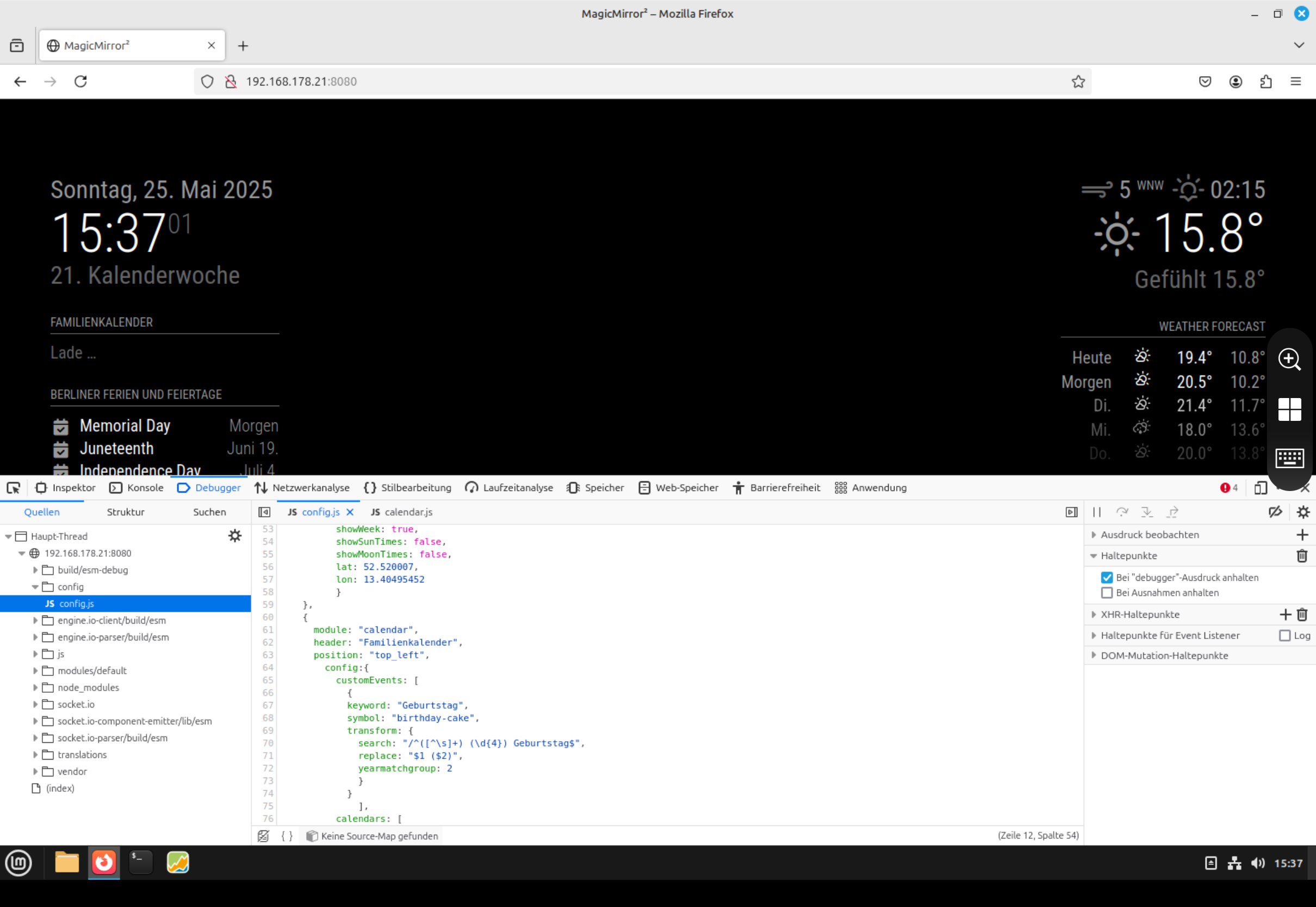

                              • P Offline
                                pauabaer @sdetweil
                                Ok. Within the regex101 there is no mistake. But when I change within the config nothing happens again.
                                  sdetweil @pauabaer
                                  @pauabaer you needed to escape the \ with another backslash
                                  in the string… its a javascript thing
                                  as I noted in my prior post
                                  also remove the leading /
                                  • P Offline
                                    pauabaer @sdetweil
                                    I did. But…
                                    I got the feeling i am not far away from the solution. Have still patient to bring me to that point? :)
                                    S P 2 Replies Last reply Reply Quote 0

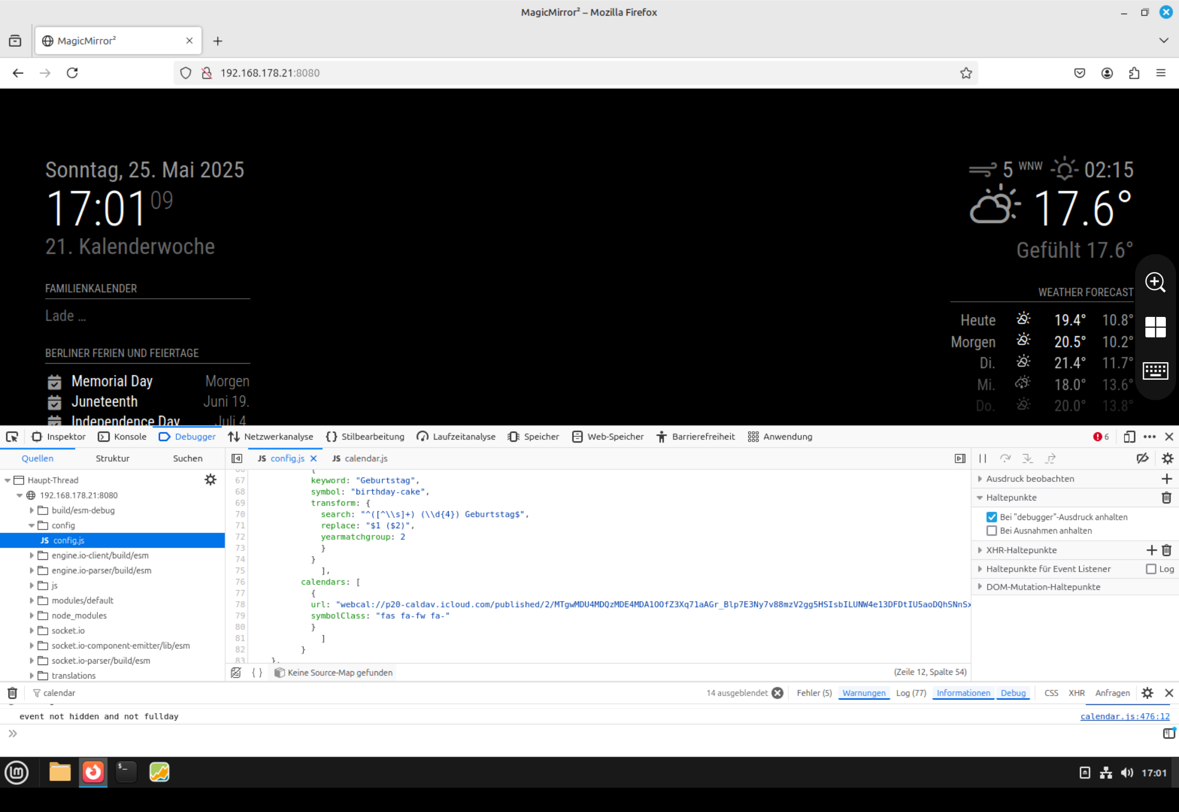

                                      sdetweil @pauabaer
                                      @pauabaer do you still see the same error in the dev console?
                                      • P Offline
                                        pauabaer @pauabaer
                                        • P Offline
                                          pauabaer @pauabaer
                                          It’s not the error I saw before.
                                            sdetweil @pauabaer
