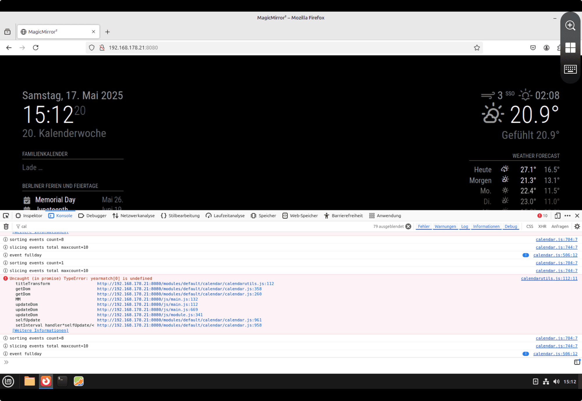

    • RE: Default calendar customEvents not working
      Thanks for helping.
      I tried to figure out. Went to the console tab and put the filter on cal.
      I get an error your yearmatch is that right? But I don’t know how to deal with it. Can you give me a hint?

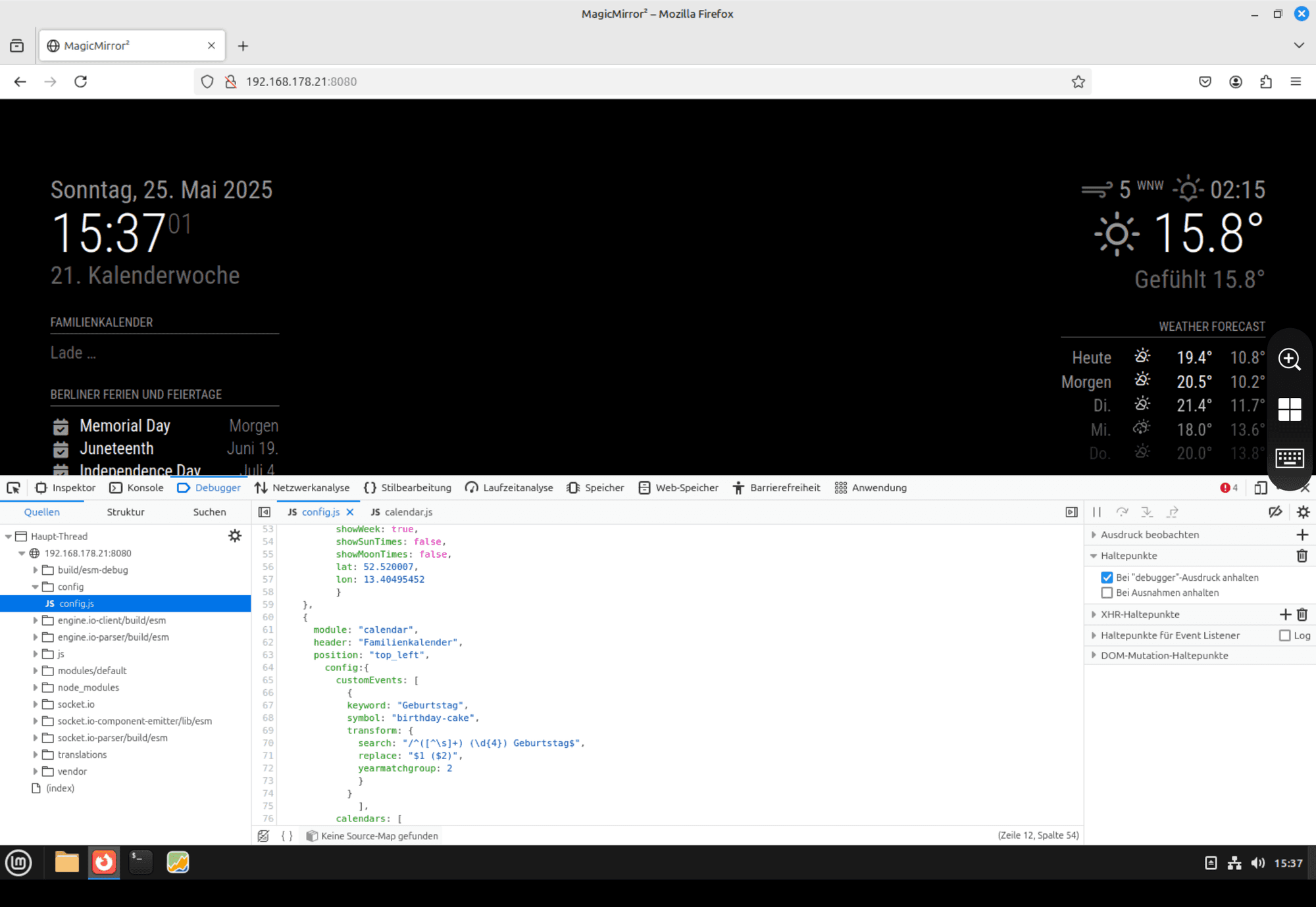

      Thank you a lot @sdetweil
      Now the right symbol is shown on my screen.
      Next I tried to use the transform option:
                              header: "Familienkalender",
                                      config:{
                                              customEvents: [
                                                      keyword: "Geburtstag",
                                                      symbol: "birthday-cake",
                                                      transform: {
                                                              search: "^(.+) (\\d{4}) Geburtstag$",
                                                              replace: "$1 ($2)",
                                                              yearmatchgroup: 2
                                                      url: "my-url“,
                                                      symbolClass: "fas fa-fw fa-"
      But when I refresh the browser whithin the Kalender „Familienkalender“ is no entry anymore but the word „loading…“ but nothing new is shown after a while.
      What could this circumstance cause?
