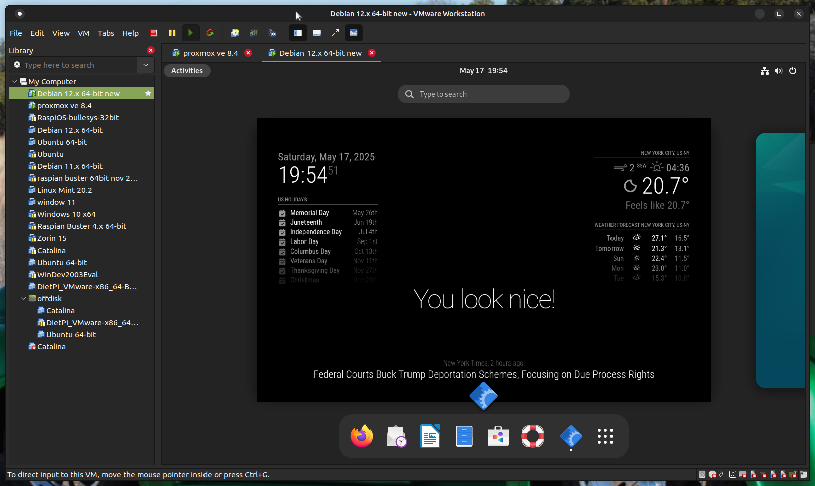

    @DarrenO-0 my mm.sh was broken, fixed now… the UI is running under wayland, not X11
    so we need a different command…
    I have fixed it, deleted the pm2 app, deleted the MagicMirror folder and then rerun the install script
    MM came up
    I rebooted
    MM came up, NOT in the full screen view but in the reduced desktop view touch it and it goes full screen like the main panel does…
    have to look at that
    if you used my installer, you can fix the one file by doing
    cd ~/MagicMirror/installers
    curl -sL https://raw.githubusercontent.com/sdetweil/MagicMirror_scripts/refs/heads/master/mm.sh >mm.sh
    sudo reboot
    mine looks like this after reboot
    S 1 Reply Last reply May 18, 2025, 1:41 AM Reply Quote 0
