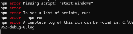

            @sdetweil what code did you use? I tried this (with and without pause at the end)
            cd MagicMirror
            npm run start:windows
            I got the following error
            This would show up for a second before disappearing. Any idea what I missed?
              sdetweil @Krowyn
              @Krowyn what MagicMirror version are you running? we’ve had these start options now for 2 releases
                      "start:windows": ".\\node_modules\\.bin\\electron js\\electron.js",
              	"start:windows:dev": "npm run start:windows -- dev",
              look at package.json version
              • K Offline
                Krowyn @sdetweil
                @sdetweil I can confirm I have both, it’s how I used to start it, but when running the .bat file i keep getting that message. Any clue what may have caused it?
                  sdetweil @Krowyn
                  @Krowyn only thing i can think is the cd MagicMirror failed because the current directory is not correct
                  where is this bat file located?
                  maybe it should be
                  cd %USERPROFILE%\MagicMirror
