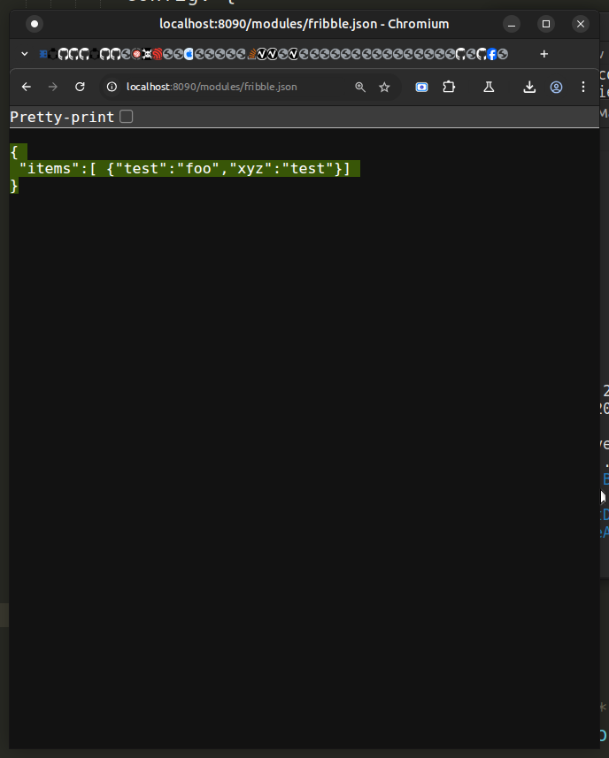

              sdetweil @mhr320
              @mhr320 ok, I put a file in MagicMirror/modules
              fribble.json
               "items":[ {"test":"foo","xyz":"test"}]
              and used this URL
              http://localhost:8090/modules/fribble.json
              and got this
              so the path works…
