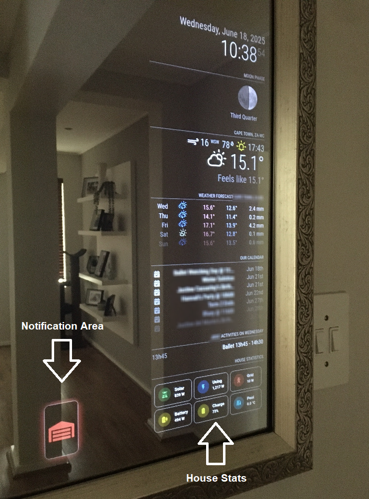

      Built our first Magic Mirror in 2019. Recently did a complete software rebuild and thought I’d share.
      The original Mirror was standalone. This version is integrated with Home Assistant ( HA ).
      Some of the cool stuff :
      • The Mirror renders an HA dashboard via an iFrame to show our house stats. Some of the figures you see there alternate every 15 seconds to display different stats with no visible refresh
      • Has a notification area ( another iFrame ) to alert you to things like the garage door is open, the hob gas is running low, etc. Notifications come and go i.e. you only see them when they need to be there
      • Uses HA for power saving. HA will turn the Mirror on or off using whose cell phone is in the house, if the alarm is on etc.

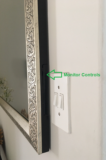

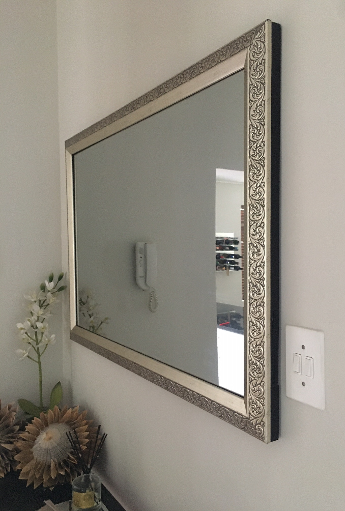

      The physical mirror measures 1025mm x 720mm. But the 20" de-cased monitor that is the Magic Mirror only occupies the bottom right. The Pi 3B+ sits 5m away in cupboard. The cabling is routed through conduits in the wall. Much grinding, much dust ! The idea was to keep the profile super low so that it looks pretty much like an ordinary mirror

        @Hilt cool stuff, that looks clean.
        Which MM module are you using to display HA as iFrame? Refresh rate 15s is a must, can it be faster refresh rate?

            @uros76 you can use MMM-HomeAssistantSensors
            No need for iframe. Then you can style them

              @sdetweil yes I know ha module, I am using it for sensors data without any fancy looks. I’m too lazy and no time to learn styling every detail 😀

                I’m using this older module as it suits my needs i.e. No configurable options for refresh. As the values change in HA, so they change on the mirror
                If you need an option with a lot more configurable options including refresh interval, have a look at this module

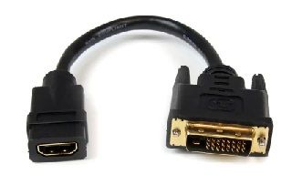

                    The secret sauce here is that this particular monitor uses an external AC adapter / power brick. That’s how I could keep everything so thin. The AC adapter sits in the cupboard with the Pi . I simply extended the barrel jack side to reach the monitor through the conduit.
                    For video signal, I used a DVI to HDMI converter ( similar to pic below ) on the monitor side , and a 5m HDMI cable back to the Pi.
                    To make space for the power and video connectors, I recessed a wall box ( like those used for your bog standard light switch ) at the end of the cable conduit and lined it all up. So said connectors actually poke back into the wall a fair bit. But the wall box hides that nicely.

                            What did you use for the frame? That looks like the same trim I use on my paintings but don’t recognize the inner bevel, did you add that onto the frame?
                            H 1 Reply Last reply Reply Quote 0
                            • H Offline
                              Hilt @jamesarm
                              @jamesarm
                              It was a regular off the shelf mirror in a frame. I just removed the actual mirror portion from the frame and replaced it with 4mm tinted glass.
