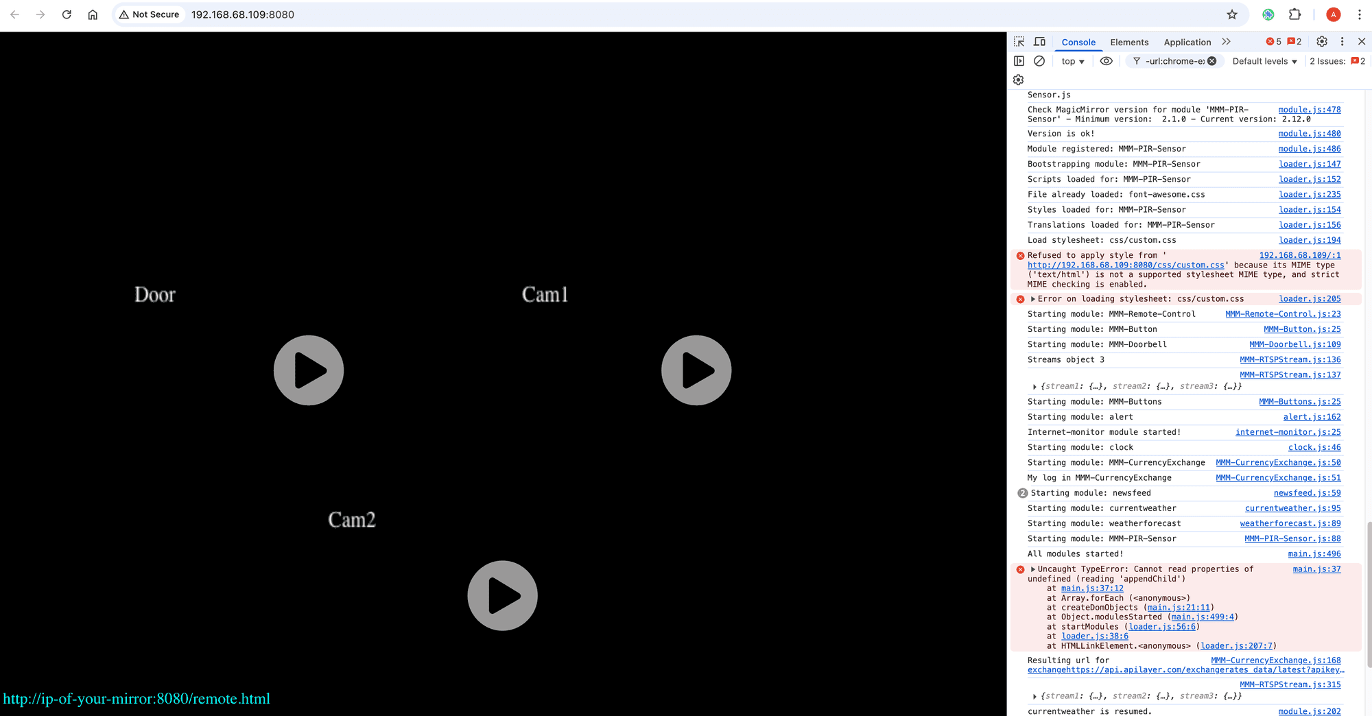

      It was working fine for months, but after trying to set a new RSS feed, all styles were broken
      Raspberry is embedded in my smart door, so I need to tear the door apart to reach it
      Is there any way to either create this file remotely or set config to bypass it?
      All other functions work as usual, not sure what’s even the root of problem
      Also found that all HTML elements (regions) have display: none; active
      Refused to apply style from 'http://192.168.68.109:8080/css/custom.css' because its MIME type ('text/html') is not a supported stylesheet MIME type, and strict MIME checking is enabled.

        @arh that just means the file is not resent, its just a warning that the page asked to load it
        this means the file system may be failing, sd cards are fragile
        same as before in your issue, we depend on user having system access

            given the weird behavior (custom.css gone missing) i’m fairly certain he has a damaged sd card now. they do fail
            and he is in the worst spot, no remote access to the file system (ssh/scp) or the system (vnc/rdp), and apparently no easy physical access.
