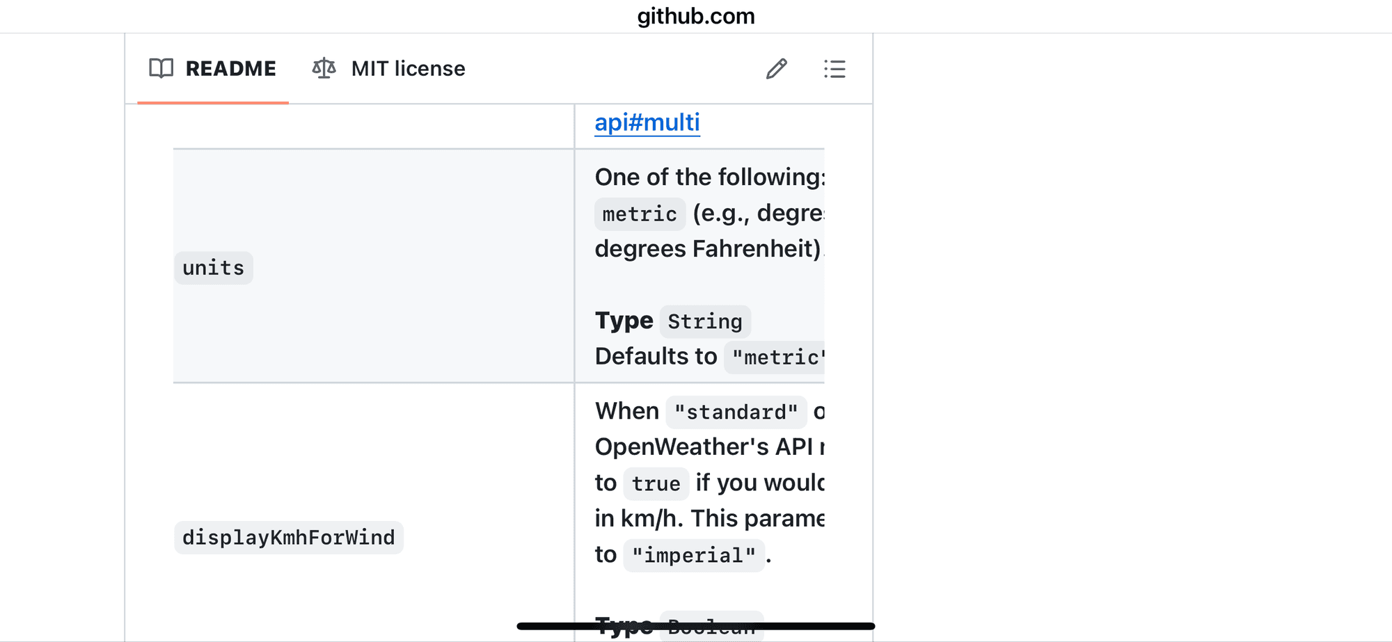

      I know this must be a basic question, but I simply cannot find a way to change the reported temperature to Fahrenheit.
        sdetweil @Athlon
        @Athlon module config option units?
        A 1 Reply Last reply Reply Quote 0
        • A Offline
          Athlon @sdetweil
          imperial (units) worked, but you knew it would :)
          Thank you!!
