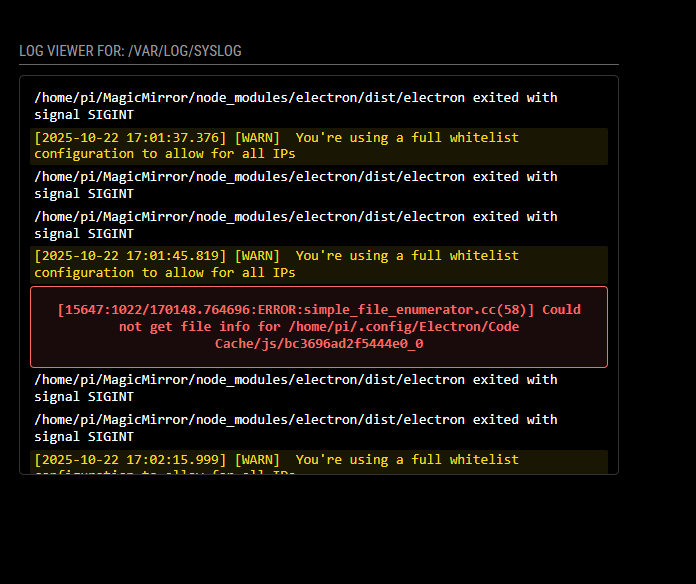

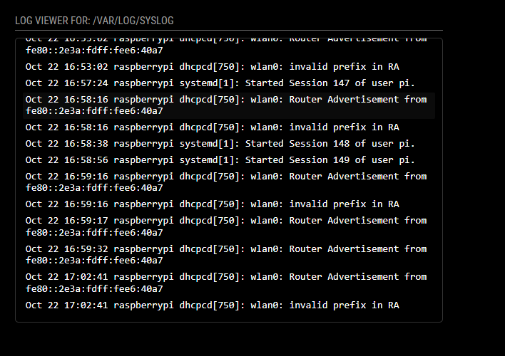

                    @MyMirror Well done :) I’ve implemented a module last week - to give you a preview:
                    With LOG-Level Highlighting:
                    Without Highlighting (because INFO, ERROR, WARN…) is not used:

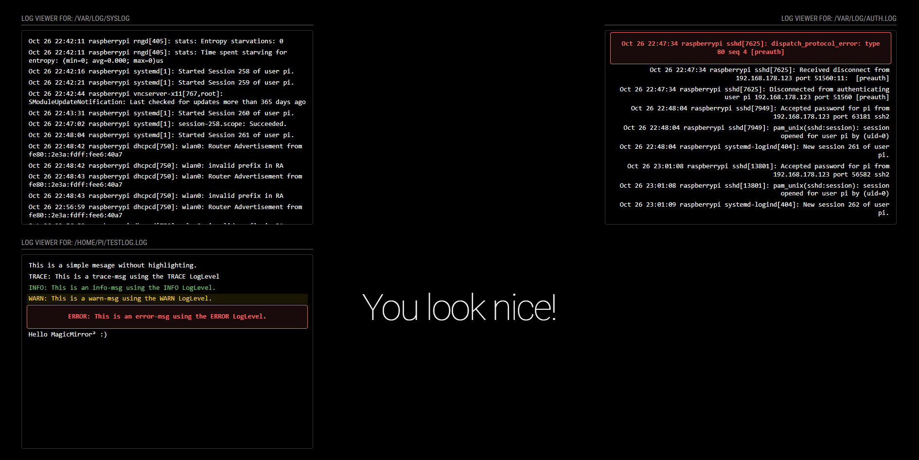

                    Right now I’m struggeling with the issue that multiple instances do not show different logs but all the time the second configured. Do you need more than one instance :D?
                    If I have some free time, I will upload the first version tomorrow or lately on Wednesday.
                    See you :)
                      sdetweil @schlomm
                      @schlomm you have to pass the instance id from the web as part of the request and send it back w the data. And the web side checks to match its id
                      sendSocketNotification from the helper is to ALL connected instances at once
