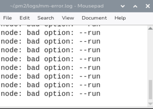

      pm2 will not launch the MM display. After executing pm2 start mm.sh, the MM display does not appear, although it shows status online. In /.pm2/logs/mm-error.log, I am seeing node: bad option: --run many times.

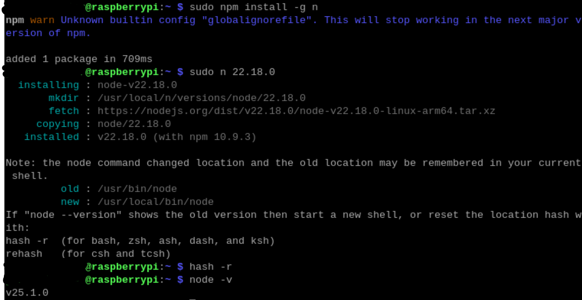

        @cyclonej we only support node 22.18.0
        Can you try to down level
        sudo npm install -g n
        sudo n 22.18.0
        hash -r
        node -v
        \# if node 22 then
        cd ~/MagicMirror
        rm -rf node_modules
        npm install
        The try pm2 stop all
        pm2 start x
        X is the name/number of the row shown in
        pm2 status
        Pm2 is started as a daemon at boot
        It might take a reboot

          cyclonej @cyclonej
          What if node is still 25?
          • C Offline
            cyclonej @cyclonej
            nevermind. now pm2 start mm works!
            i dont know what those commands did, but it worked
