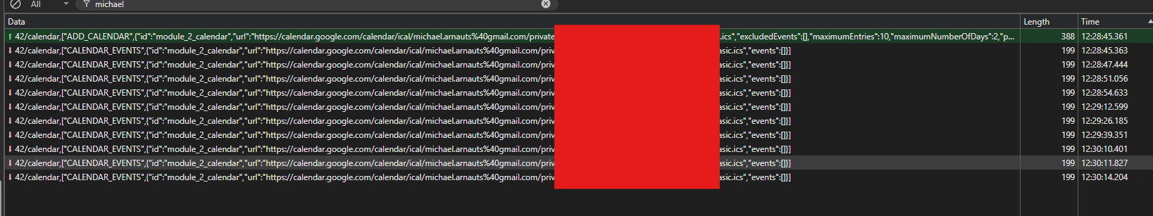

                  • M
                    michaelarnauts @sdetweil
                    That makes sense, but I see a lot more updates then what you describe here.
                    I’ve added a screenshot of the updates I get to my github issue, and I’ve added it here as well. (note that all the messages have the same length, and some are a few seconds apart.
                    I’m not sure how to proceed in troubleshooting. When I enable debug logging, it is outputting a LOT (the whole ics file contains data from years ago).
