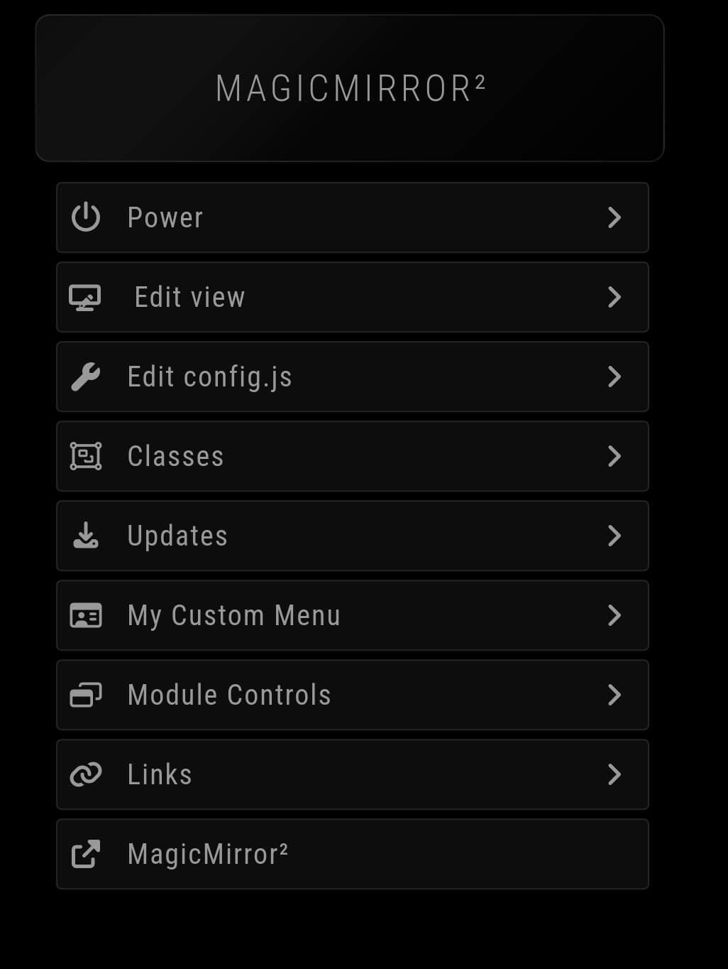

      Main Menu

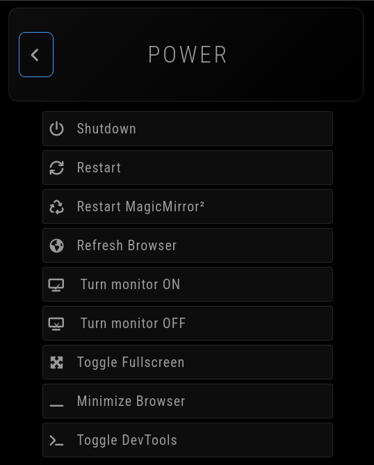

      Power Menu

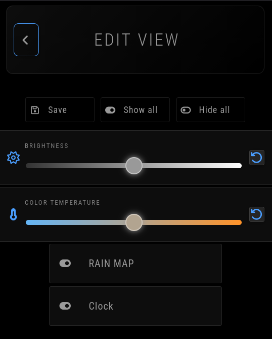

      View Menu

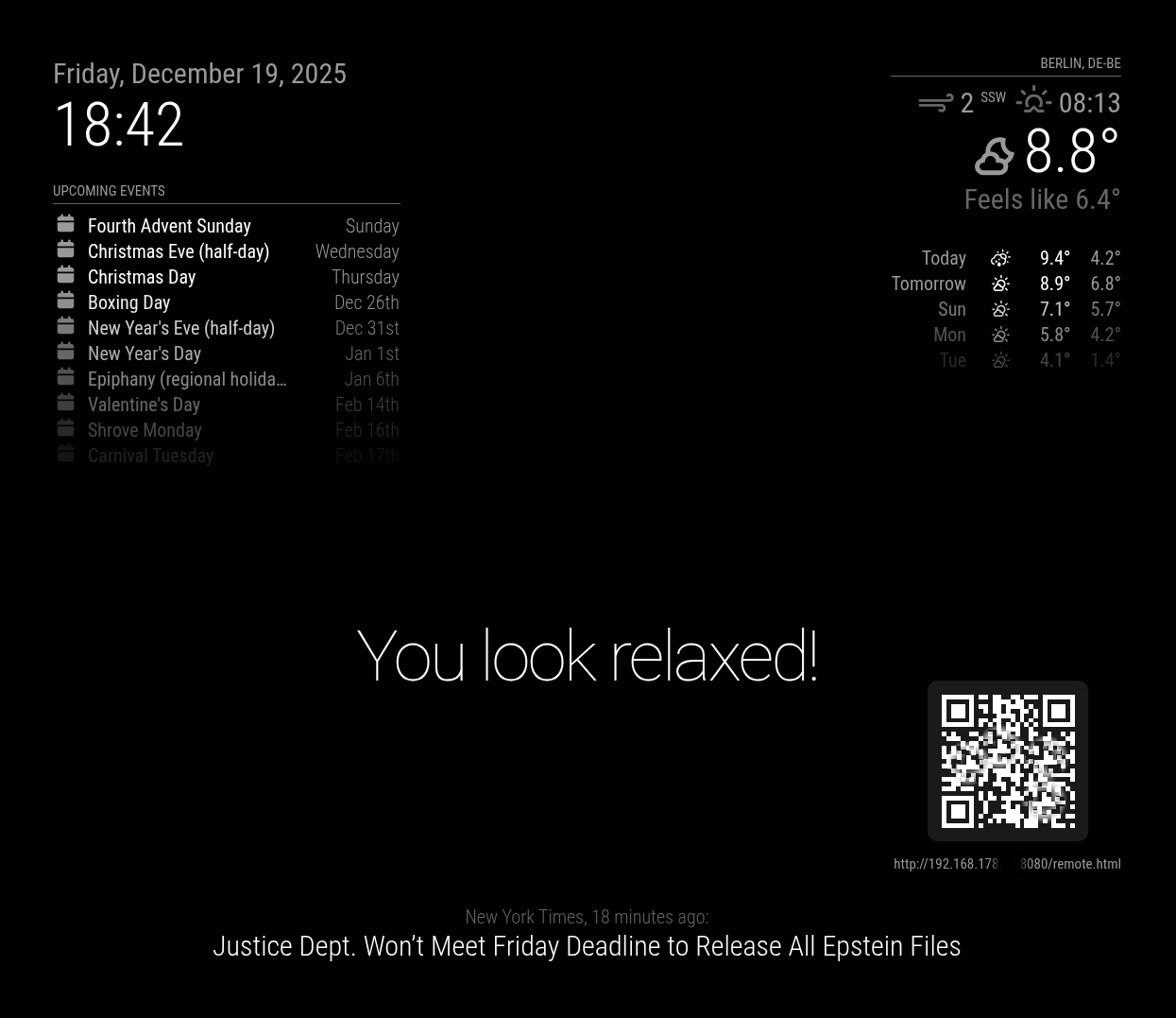

      optional QR Code on the mirror
