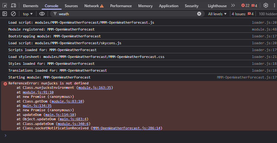

      @sdetweil I was pretty sure I did but I ran it again and rebooted the mirror to the same results. Still the same error as the above screenshot in the dev tools console. Not sure if it matters, but I do have the mirror booting headless. I don’t remember exactly but it’s part of the startup script so when I reboot the pi, it automatically runs MM and loads it onscreen

                  Can you Open the developers window
                  ctrl-shift-I
                  Select the console tab
                  Add weath to the filter field
                  F 1 Reply Last reply Reply Quote 0

                    fnmuffinman @sdetweil
                    @sdetweil No worries, I figured you were probably busy! Here is what comes up
                      sdetweil @fnmuffinman
                      @fnmuffinman ok, a little more debug
                      grep nunj package.json
                      should return
                      		"nunjucks": "^3.2.4",
                      then
                      cd node_modules
                      ls nunjucks -laF
                      should return (I am on mac at the moment, with MagicMirror just installed, so dates will be different
                      drwxr-xr-x   10 sam  staff    320 Feb  3 08:20 ./
                      drwxr-xr-x  685 sam  staff  21920 Feb  3 08:21 ../
                      drwxr-xr-x    4 sam  staff    128 Feb  3 08:20 bin/
                      drwxr-xr-x   10 sam  staff    320 Feb  3 08:20 browser/
                      -rw-r--r--    1 sam  staff   2309 Feb  3 08:20 index.js
                      -rw-r--r--    1 sam  staff   1311 Feb  3 08:20 LICENSE
                      drwxr-xr-x    3 sam  staff     96 Feb  3 08:20 node_modules/
                      -rw-r--r--    1 sam  staff   3138 Feb  3 08:20 package.json
                      -rw-r--r--    1 sam  staff   2127 Feb  3 08:20 README.md
                      drwxr-xr-x   23 sam  staff    736 Feb  3 08:20 src/
                      then I want to redo the MagicMirror npm install
                      rm -rf node_modules
                      then restart MagicMirror however you do it…
                        @sdetweil alright so i ran those commands. when I got to
                        ls nunjucks -laF
                        It returned that directory did not exist, which i would imagine is part of my issue. I then continued with the rest of the commands, then I got this error.
                        For context, recently I saw notifications on my mirror stating some modules needed to be updated. I ran through the docs for updating those but it’s possible I messed that up and caused myself a bigger problem here.
