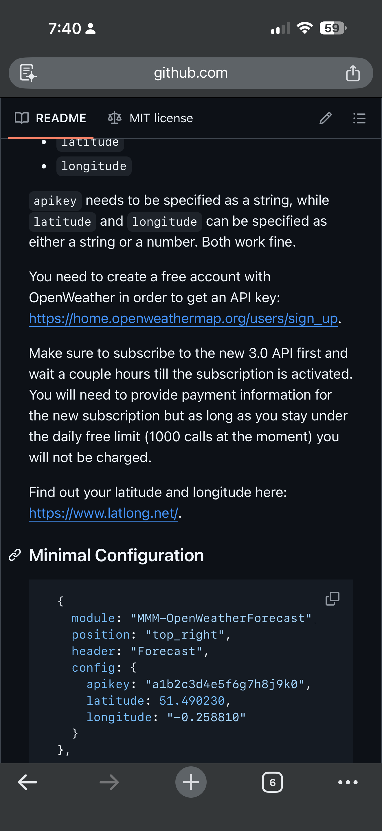

                    Tom’s is v3 api only
                    The original is v2.5 only

                        I was seeing a 401 Unauthorized error for a bit but figured out the 3.0 API call thing. I did test the URL from the website with my lat and long with the API key it works. I no longer see those errors in my pm2 logs on the mirror. Here is a screenshot of my current config in the config.js as well
                        Sorry didn’t want to dox or give my api key :) also as further troubleshooting, here is a screenshot of the api.openweathermap.org URL to show it does work

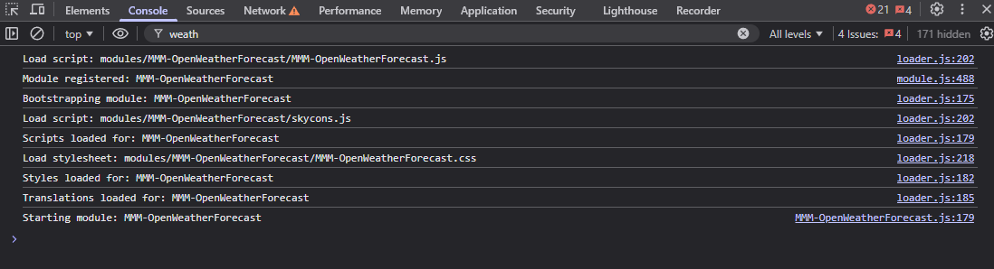

                                        Can you Open the developers window
                                        ctrl-shift-I
                                        Select the console tab
                                        Add weath to the filter field
                                        F 1 Reply Last reply Reply Quote 0

                                          fnmuffinman @sdetweil
                                          @sdetweil No worries, I figured you were probably busy! Here is what comes up
