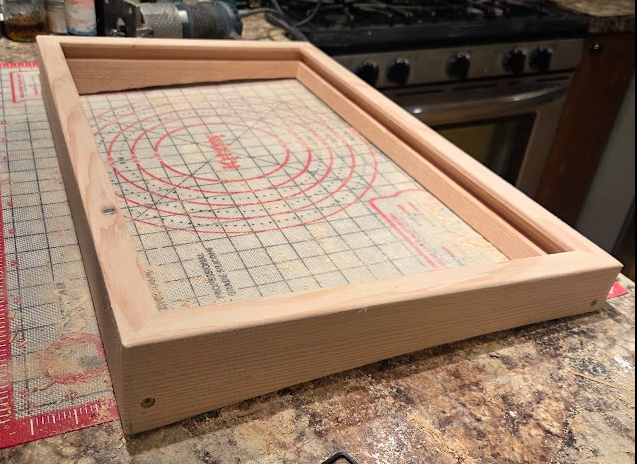

The hardest part was definitely making the custom wood bezel - I was a woodworker, but matching the profile of the refrigerator, keeping weight down, minimizing the profile, and ensuring I only have one flexible cord having to make the corner from fridge side into the MM was definitely a challenge.
So far, my wife is really happy with it, and is eagerly submitting feature requests. Ok, sigh, that part might get a little tiring!!!
The bezel is Douglas fir, which is much lighter than my preferred maple, but also easier to mill:

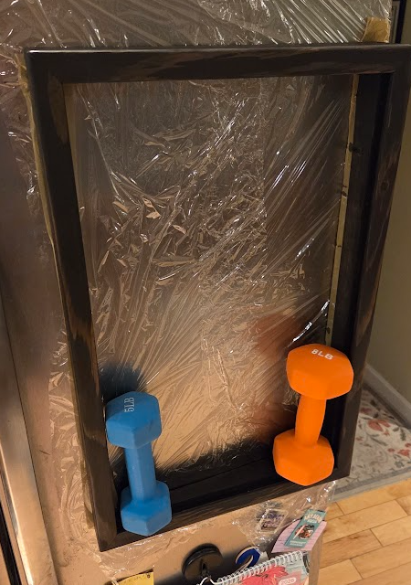

After countersinking and wet-setting the 16 N42 5/8" magnets, I attached the chassis to the refrigerator door with some seran wrap - this allowed the magnets to align with the door for the best contact surface, and I let it cure overnight. Testing with a few dumbells made me more confident that I’d used enough magnets!!

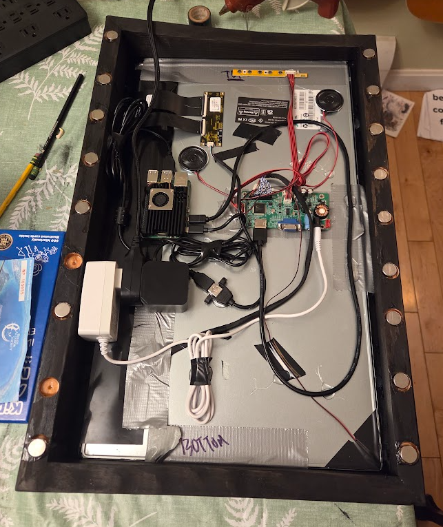

NO project would be complete without a late night final assembly, including duct tape and PLENTY of hot glue lol.
