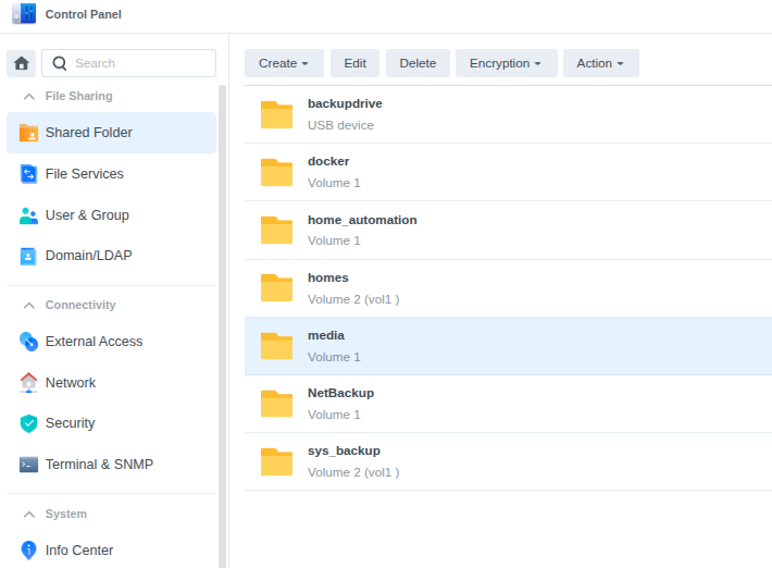

                      if your NAS is Synology, like mine
                      create a shared folder using the Control Panel, Shared folder function

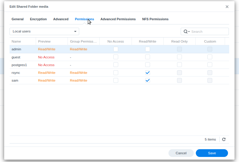

                      make sure the permissions are set for whatever user will be accessing it (here sam for me)
