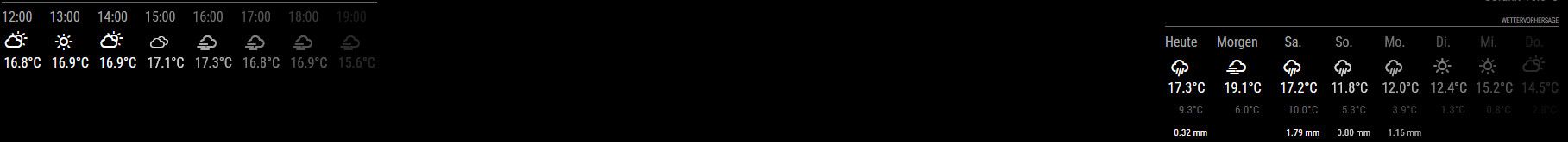

              OliWer @sdetweil
              Something like this?:
              left hourly and right daily forecast, using openweathermap as API provider, but that should not make a difference.
              Is this something that could be build into the default module? I’m currently testing it with a configurable layout option and could provide my changes if that makes sense.
                sdetweil @OliWer
                @OliWer possibly. You are the first to want this kind of layout.
                You could submit a pr and see what happens.
