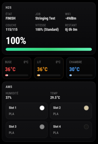

      Bambulink Module for MagicMirror
      Module: MMM-Bambulink
      This MagicMirror module,
      MMM-Bambulink is a third-party module for MagicMirror² designed to display information about your Bambu Lab printer directly on your MagicMirror screen. The module connects to your printer over the local network using Bambu Lab’s LAN credentials and updates information automatically at a configurable interval.
      Important: ONLY LAN mode NOT must be enabled on the printer.
      Requirements
      To use this module, you need the following information:
      • The IP address of your Bambu Lab printer
      • The printer’s LAN Access Code
      • The printer serial number
      These three values are required in the configuration to establish the connection with your printer. MagicMirror² documentation recommends clearly listing required external dependencies and setup information in a module README.
      Key Features
      • Monitor your Bambu Lab printer directly from MagicMirror².
      • Secure local connection using MQTT/TLS on port 8883.
      • Configurable refresh interval for automatic updates.
      • Custom printer title using the printerModel option.
      • Two temperature display modes:
        • tile view (tiles)
        • graph view (graph)
      • Visual AMS display including:
        • AMS temperature,
        • filament color,
        • loaded filament type for each slot.
      • Automatic highlight of the active AMS slot during printing, including when the printer switches filament. Bambu’s AMS workflow is built around slot-based filament selection and color mapping, which makes this type of visual highlighting consistent with how AMS data is handled in local workflows.
      • Simple installation inside the standard MagicMirror² module structure.
      Development Status
      The module is functional and ready to use in a standard MagicMirror² environment. Installation, Node.js dependencies, configuration, and update steps follow the usual module workflow inside ~/MagicMirror/modules, which is the standard location for third-party MagicMirror² modules.
      The project is still evolving, especially in terms of UI improvements, advanced display options, and visual customization.
      Compatibility
      MMM-Bambulink is designed for MagicMirror² and Bambu Lab printers with LAN mode enabled.
      The required parameters such as ip, accessCode, serial, mqttPort, and useTLS indicate that the module is intended to communicate with the printer locally through a secure network connection.

        0.2 Graphical module done !
