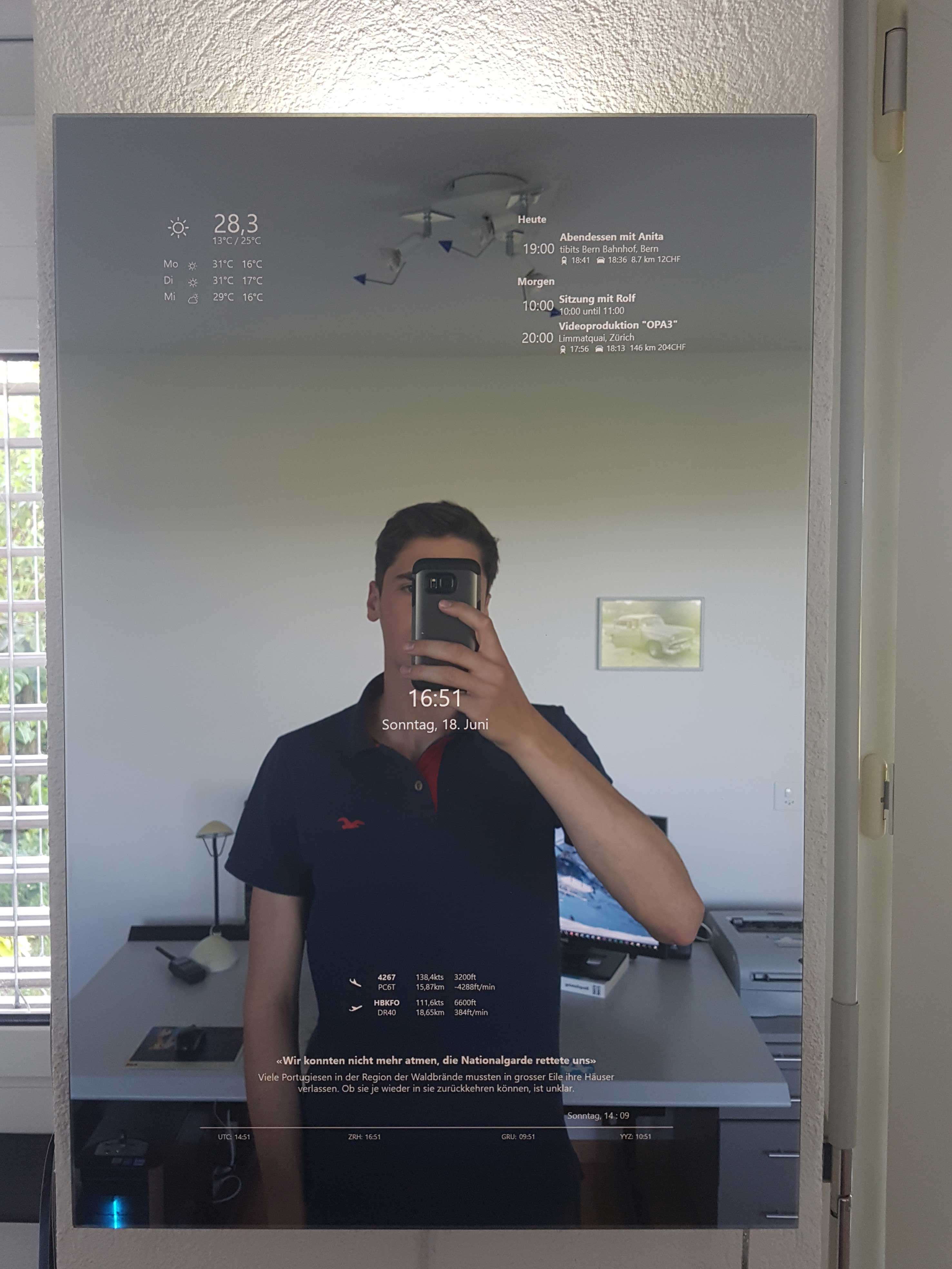

      My first 400x600mm magic mirror (24" screen) is now finished!
      I decided to develope the mirror with Windows 10 IoT and a Raspberry.
      It’s all self-coded as an UWP-App for the Raspberry Pi 2.
      Software features: (Running on a Windows 10 IoT)
      • Weather Conditions live from Weatherunderground via API
      • Weather Forecast for the next 3 days from Weatherunderground API
      • Calendar Items over Google Calendar (there is no API available for UWP so i had to call it via REST and OAUTH)
      • Calcultes the needed time to drive to the calendar event (live traffic jam and public transportation delays - GoogleMaps API)
      • Station-List for the next public-transportation connections outbound the near train station (not visible in this picture)
      • Of course the actual time (switchable to an analog-clock)
      • Actual News over an RSS-Feed
      • Flightradar binding, which is showing the nearby aircrafts
      • World time with some important time-zones

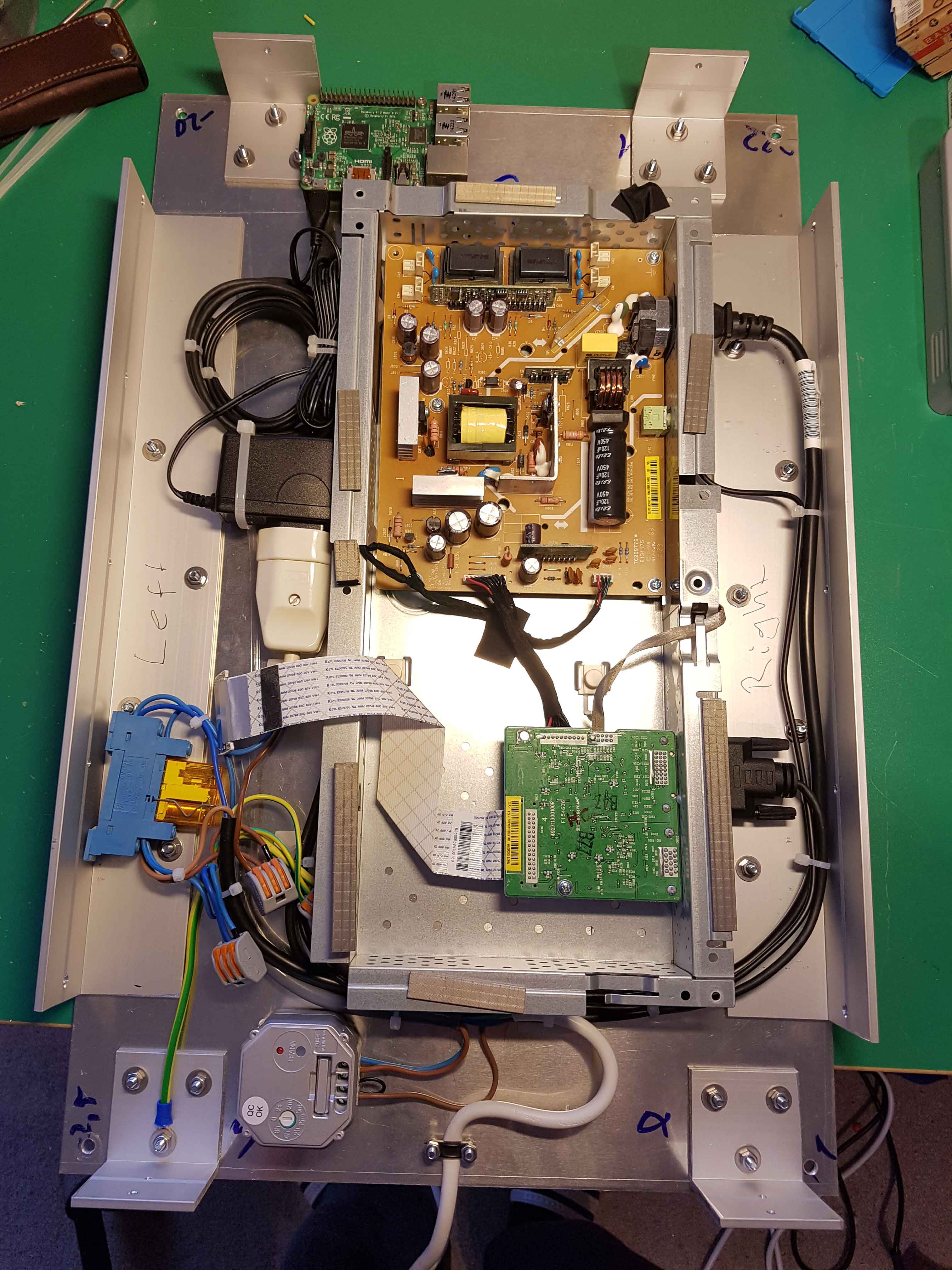

      Hardware components:
      • 24-inch HP monitor without frame
      • Raspberry Pi 2
      • TP-LINK Pocket AP Router TLWR802N (WiFi to Ethernet for better range)
      • 433 MHz relay to switch the mirror on and off with a remote control
      • 400*600mm 4mm 20% Mirror from Glas-Trösch (Switzerland)
      Electrical wiring:

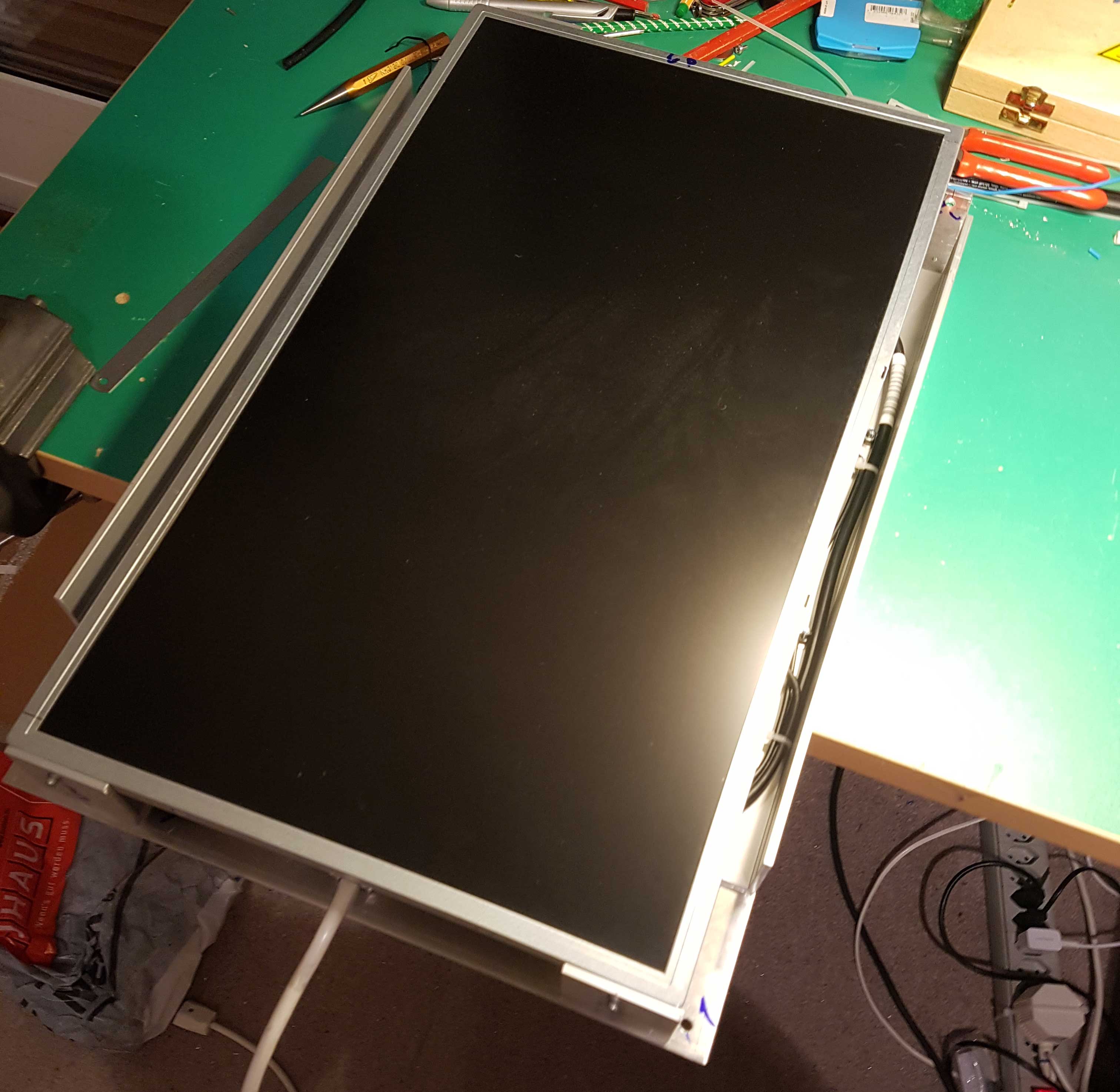

      Mounted screen:
      Final device:

        Nice job, looks really cool. I’d love some more pictures of the final product, especially since you developed your own system.
